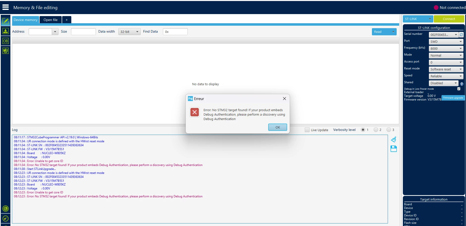

Issue connecting the NUCLEO-WB05KZ to the STM32CubeProgrammer
Hello
thanks for replying.
to upload the Hex file i used STM32Programmer, but when i connect the borad via USB cable to my PC i receive un error :
Best Regards.

Mar 11, 2025 8:50 AM UTC
Hello @ljm
Could you please try to follow this procedure:
  • If it is the first time you will program the board, follow the recommendation of the note on the chapter 7.12 of the STM32WB05 Nucleo-64 board (MB1801 and MB2032) - User manual and don't forget to click on the reset button before connecting to the STM32CubeProgrammer if the LD2 is still toggling.
  •  If you are used to program the board, try to fit the jumper on both pins 7 and 5 on the CN3 of the board and connect the board using the Hot plug mood
PS: Make sure to use the STM32CubeProgrammer V2.19.0

ljmAuthor
Mar 12, 2025 7:16 AM UTC
Thank you for replying
i have an issue to connect the board to STM32Cube programmer
thanks
STTwo-32
Mar 12, 2025 7:51 AM UTC
Have you followed the steps I've mentioned in my previous post.
Best Regards.
