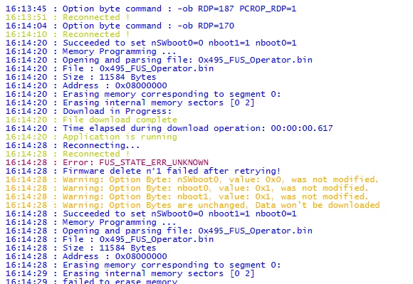

Issue: Attempting to flash firmware onto coprocessor on STM32WB55RGV6 results in Error: FUS_STATE_ERR_UNKNOWN
Greetings,
I have my STM32WB55RGV6 connected to my computer through USB using the ST-LINK port on the board. When trying to flash the coprocessor to run an example application from the WB firmware package, I cannot even erase the previous firmware.
Using the commands from the attached link results in an error to erase the firmware, with message FUS_STATE_ERR_UNKNOWN. I have no problems flashing the main processor with binaries using this tool or armKEIL, but for some reason I cannot get the hang of this. I have even tried following the release notes addresses for programming but nothing seemed to work.
Does anybody have a solution for this issue?
Thank you for your attention, I have added some screenshots below to make my issue easier to understand.
1- Initial Connection using st-link
3- attempting to flash FUS firmware
4 and 5 - Attempting to flash BLE full stack firmware

eddie McS
Aug 18, 2020 3:21 PM UTC
I'm just trying to flash the BloodPressure example.
unfortunately when i try to delete the firmware i get the error FUS_STATE_ERR_UNKNOWN so i can never get back to that good starting point

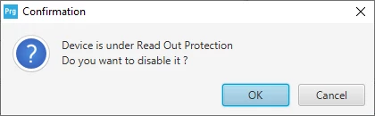

Remi QUINTIN
Aug 18, 2020 3:29 PM UTC
Ok ​let's go through the USB port.
Before switching to USB port, set the nSWboot option byte to 1 .
When this is done, set the jumper on CN7 in between pins 5 and 7 and switch to the USB port. Then you will be able (I hope) to connect in GUI mode and read the FUS version. Retry the fwdelete command... and let's see!
Remi QUINTIN
Aug 18, 2020 3:30 PM UTC
set also the reset mode to HW reset​
eddie McS
Aug 19, 2020 8:07 AM UTC
I placed the board into DFU for USB connection and seen the port USB1 available for connection. However Its complaining about Read Out Protection and wont connect even tho in SWD i confirmed RDP Byte is set to AA.
Remi QUINTIN
Aug 19, 2020 11:24 AM UTC
In fact, just saw that the ESE option byte is not checked. So no FUS is available on that chip as it is a non-secure chip.
Therefore, no way to load any encrypted BLE stack as no FUS is there to encrypt it and install it properly.
At the opposite, you can use it to load your own BLE stack on the M0+ or any other stack but you won’t get any support with this configuration as it is not the standard one.
