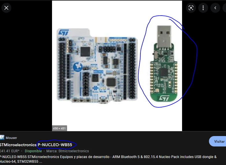

Is there any BLE example to send memory data from the microcontroller to the PC?
I want to send ADC data to the PC using BLE.
The ADC data is directly connected to the DMA,
So, sending DMA data is also fine.
Is there any example or source code for it?
I'm using the Nucleo-WB55 board.

Javier1
Principal
May 3, 2022 2:25 PM UTC
Does your PC have BLE capabilities?
How frecuent do your ADC measurements need to be?

Javier1
Principal
May 5, 2022 10:59 AM UTC
You could use USB communication from a BLE dongle
BLE is not meant to be Fast, and its not easy to develop (at least it wasnt for me)
Why do you want to use BLE and not just USB

I can connect the STM32WB board to the PC using Bluetooth LE explorer built by Microsoft. isn't modifying it possible to collect data?

Remy ISSALYS
May 5, 2022 4:52 PM UTC
You can use Bluetooth LE Explorer software on your PC in order to connect your board to your PC via BLE.
