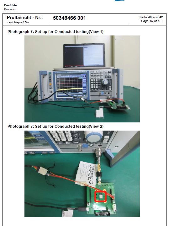

YKang.5
YKang.5Author
Nov 4, 2022 11:15 AM UTC
Thank you for your reply.
Nevertheless, I want to get new FCC ID for newly developed devices which is using STM32WB5MMG.
0693W00000WHSNjQAP.png​
At photograph 8, the antena(or RF output)is connected to measurement equipment using some kind of connector, and it controlled by USB, I guess.
In conclusion, I would like to know the HW(like above photograph 8) and FW setting.
Sincerely.​

Remi QUINTIN
Nov 4, 2022 1:44 PM UTC
I understand the picture demonstrated the test of another module and you would like to be able to do the same with the STM32WB5MMG module.
Why do you need to perform conducted tests? ... as the module is already FCC certified.

Remi QUINTIN
Nov 7, 2022 5:20 PM UTC
You do not need to perform conducted test, radiated test are enough for the FCC when using a certified module on a board.
