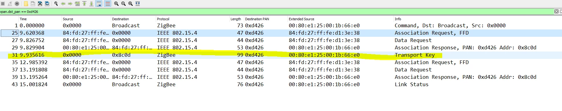

I have a STM32WB55 (P-NUCLEO-WB55-NUCLEO board) Zigbee coordinator to which I am trying to join an Ikea Tradfri bulb, but I cannot get the bulb to join.
The bulb locates the network but fails to join. There is a 'Transport Key' message but no 'Device Announcement' message.
I have flashed the co-processor with Zigbee FFD v1.13.2 firmware.
I believe I have configured the STM32WB55/coordinator as a Trust Center.
My starting project was the 'Zigbee_OnOff_Server_Coord' V1.13.3 example. I have modified it to use channel 15 and I (think I) have also enabled Trust Center in APP_ZIGBEE_NwkForm:

Here's an image of the sniffed network messages. There isn't a 'Device Announcement' message after the 'Transport Key' message:

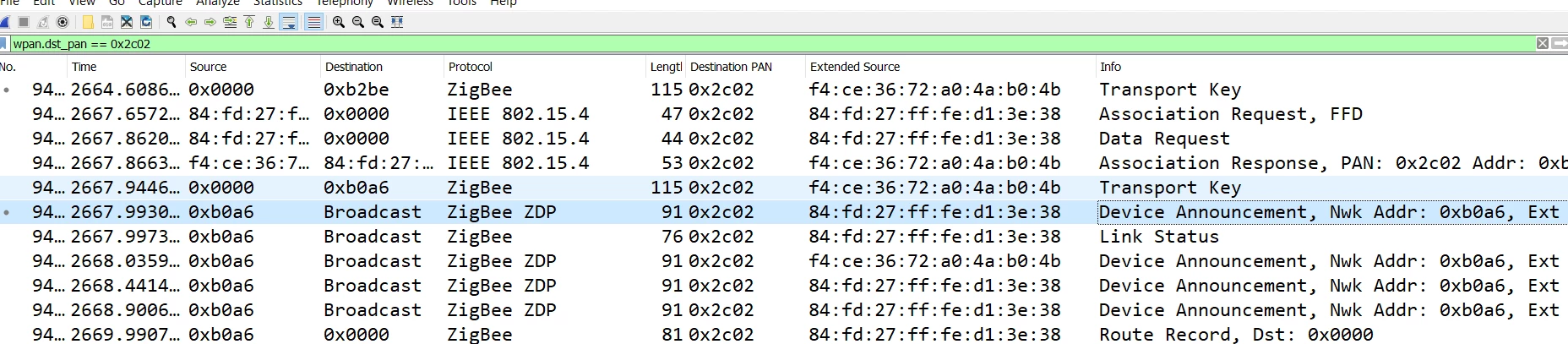

0693W00000NozoTQAR.pngI have successfully connected the same bulb to a different (non-STM32) coordinator. The sniffed traffic in this case shows a 'Device Announcement' after 'Transport Key': (I think this proves the bulb is working ok)
