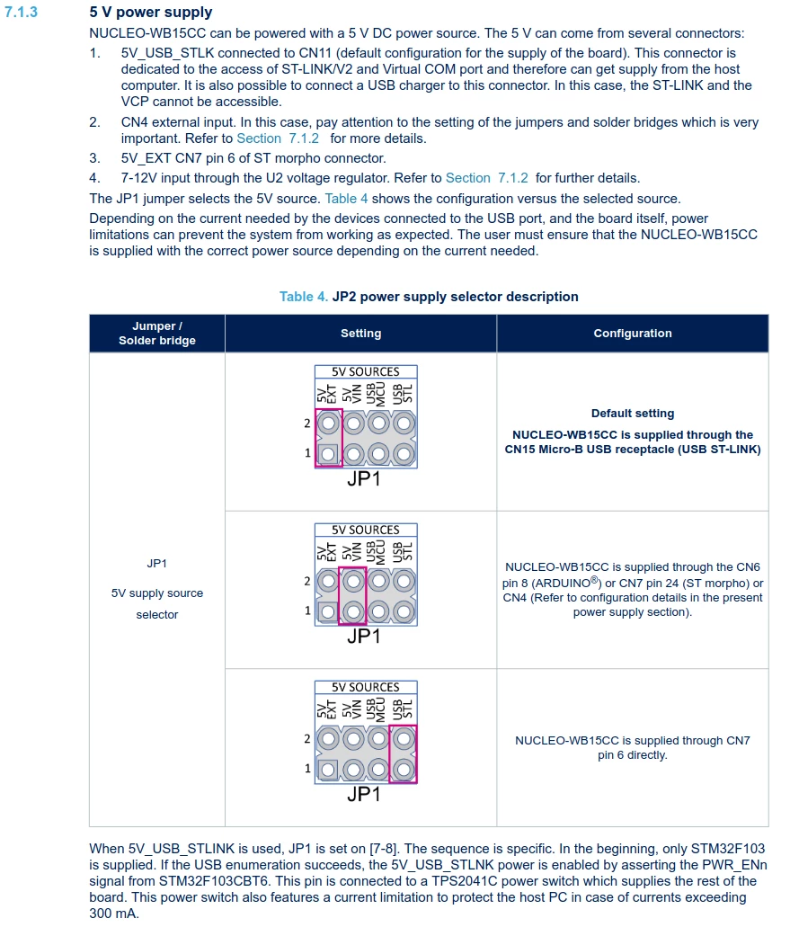

I was a bit confused by Table 4 in chapter 7.1.3 page 13. It is UM2823 - Rev 1.
The description for [1-2] claims to be the default setting and describes what sounds to me like [7-8] called "USB STL" and the description for [7-8] sounds like external power so [1-2]? Have the information been mixed up?
And the table name says JP2 since I am at it :)

Hello @obj87
Thank you so much for reporting this issue. I confirm there is a typo on the description of table 4 (the pictures on the first configuration should be on the third and the one on the third should be on the first configuration). I've escalated for correction on the coming releases of the document (under internal ticket number 191710).
