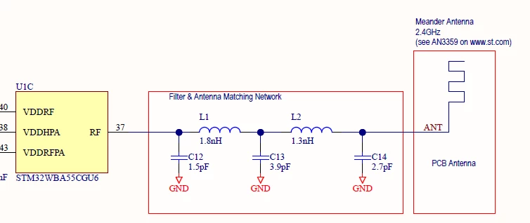

Is the Filter & Antenna Matching Network for STM32WBA5 also apply to STM32WBA6?
Also application note AN5948 (How to develop RF hardware using STM32WBA5xxx MCUs) apply to STM32WBA6?

Hello @sunnykuni
The Filter & Antenna Matching Network of the STM32WBA5 also apply on the STM32WBA6. For the AN5948, it will be updated on the future to add the compatibility with the STM32WBA6.
