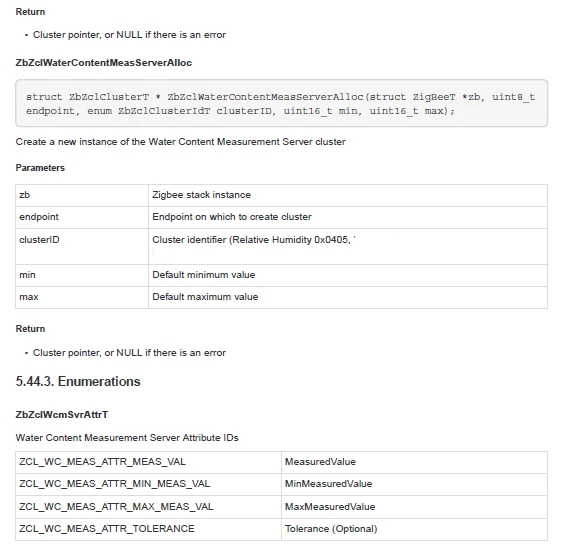

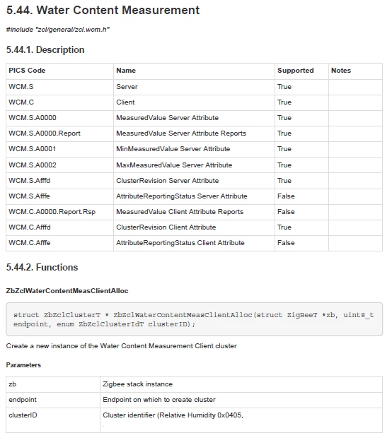

Remi QUINTIN
Feb 16, 2021 1:08 PM UTC
Relative Humidity cluster (0x405) is supported on STM32WB.
Cluster API can be found in zcl.wcm.h
Unfortunately, the Application Note which describes how to use this cluster on STM32WB is not yet released, but it is just a matter of days.
In the meantime, please find hereafter the associated description of the APIs present on STM32WB which can be used in order to activate the Relative Humidity cluster :
For more detail, please refer to ZCL cluster library.

LeoGrany
LeoGranyAuthor
Feb 16, 2021 1:17 PM UTC
Remi,
Thank you for your answer!
I would have never guessed that the cluster API for relative humidity would be named wcm!
I'm going to try it!
