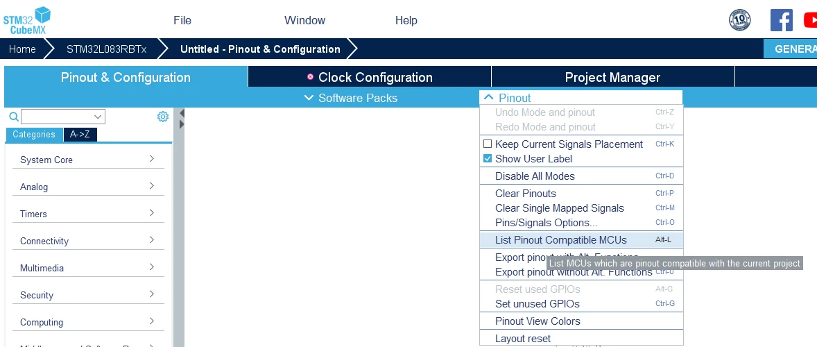

Generally speaking, In CubeMx it is possible to change MCU type:
_legacyfs_online_stmicro_images_0693W00000dJxTBQA0.pngIt is maybe better to install STM32CubeMX separately than use integrated version in CubeIDE. Then there is wider possibilities to save .ioc with different name etc.
Remember to backup your project before start.

Thank you very much, I have tried as you said. I can set the pin to match the RAK3172, but I can't save the original project, it lets me save it as a new project, which is no different than when I created a new project.
