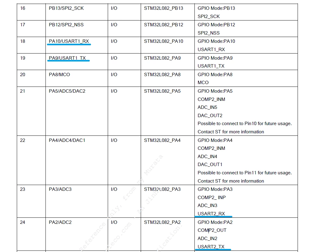

Hi
I use 'PRINTF' and 'AT command' using vcom.c from the I-CUBE-LRWAN source.
And develop in the following situations.
1. UART communication uses RS-232.
2. I use  STM32L082 low-power chip.
3.I use LPUART and NVIC interrupts.
and then, I made the following changes and tested them.
1.change uart port. (usart2 - > usart1)
2.in usart1 port i uses RS-485.
Then PRINTF and AT-command do not work.
Do you have to add other parts to the following sources when using rs-485? Or can you use usart1 as the uart port of lpuart? (See terminal configuration)

 LL_RCC_SetLPUARTClockSource(LL_RCC_LPUART1_CLKSOURCE_HSI);
 UARTX_CLK_ENABLE();
 vcom_IoInit(); /* init vcom */

void vcom_IoInit(void)
 GPIO_InitTypeDef GPIO_InitStruct;
 /* UART TX GPIO pin configuration */
 GPIO_InitStruct.Speed = GPIO_SPEED_FREQ_MEDIUM;
 GPIO_InitStruct.Alternate = UARTX_TX_AF;
 HW_GPIO_Init(GPIOA, GPIO_PIN_9/*this point change*/, &GPIO_InitStruct);
 /* UART RX GPIO pin configuration */
 GPIO_InitStruct.Alternate = UARTX_RX_AF;
 HW_GPIO_Init(GPIOA, GPIO_PIN_10/*this point change*/, &GPIO_InitStruct);
