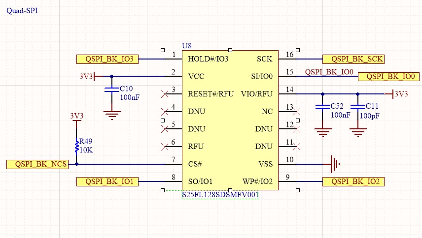

I am fiddling with a STM32WB5M discovery kit.
This kit includes a QuadSPI external NOR FLASH chip and i need to understand this in order to make early design choices.

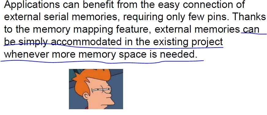

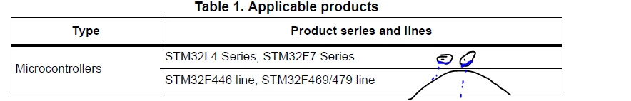

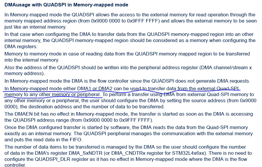

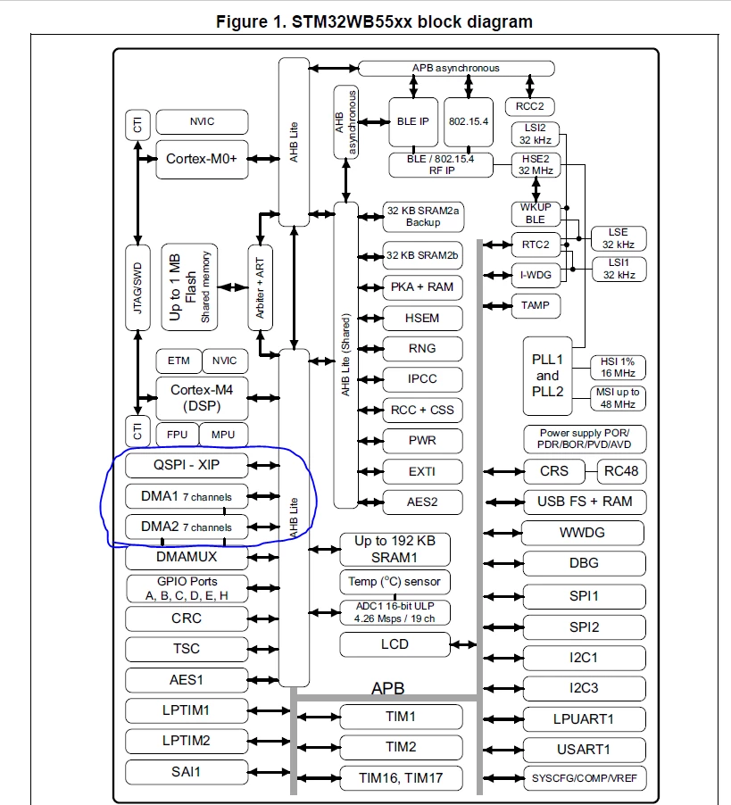

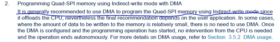

Quick read to:
AN4760 Quad-SPI (QSPI) interface on STM32 microcontrollers0693W00000Y7jBEQAZ.pngStill a bit foggy..... it looks like we could use DMA to access QSPI external flash memories.
Lets see how straightfoward it actually is
there is a posibility STM32WB doesnt support this
hit me up in https://www.linkedin.com/in/javiermuñoz/
Javier1
Javier1Author
Principal
Jan 9, 2023 12:40 PM UTC

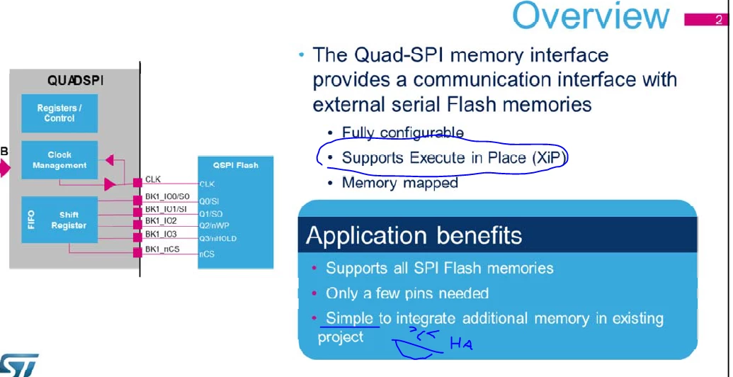

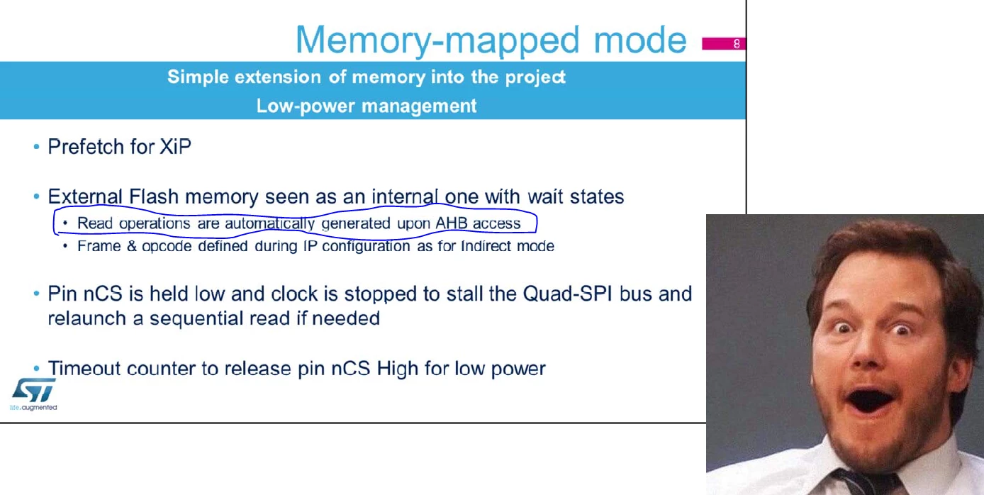

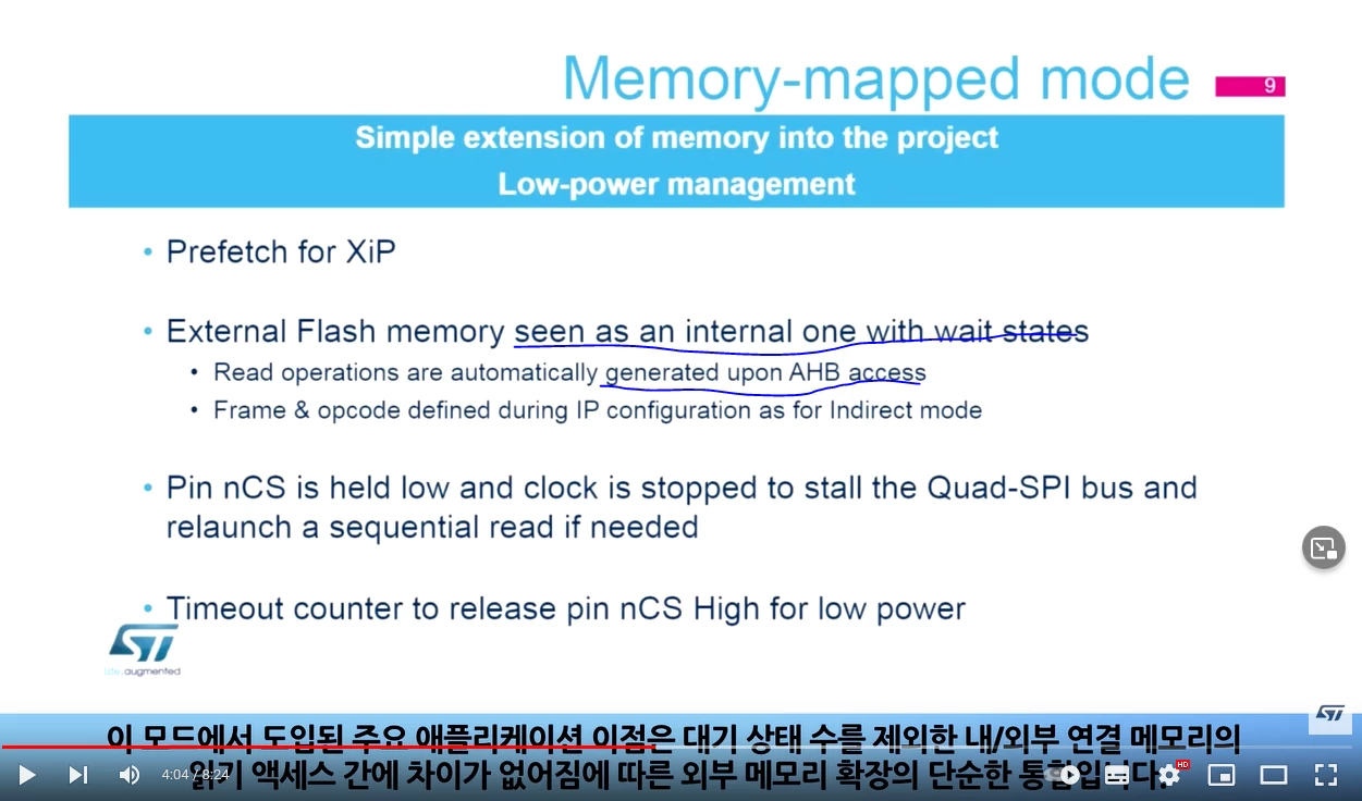

whatching ST video:https://www.youtube.com/watch?app=desktop&v=4Yck17zU2u4
It could indicate we could use DMA with it ONLY READ OPERATIONS (which is fine by me)
This other video MOOC:https://www.youtube.com/watch?v=ElFH5JdtvYg&list=PLnMKNibPkDnEEvQWrDqVuu1w_iQ214GXi&index=11

Pavel A.
Jan 9, 2023 1:17 PM UTC
The fine manual usually has the bus matrix picture, it shows which DMA is connected to which memory or module. Look at that. I don't have the STM32WB, but if its HAL QSPI library has DMA API, it likely works with DMA (though not in memory mapped mode).

 >>The fine manual usually has the bus matrix picture
the STM32WB5M discovery board mounts a STM32WB5MMGH6 SoM, which mounts a stm32wb55vg
for sure DMA running the QSPI peripheral . But i was looking for a firmware-transparent way for the DMA to access an external Flash connected trough the QSPI as if it were internal FLASH connected to the AHB.
Thats the reason why im looking for the memory mapped mode.
Pavel A.
Jan 9, 2023 9:37 PM UTC
This is a block diagram. Is there another picture for the bus matrix ?

Jan 10, 2023 5:45 PM UTC
Javier1
Javier1AuthorBest answer
Principal
Jan 10, 2023 6:01 PM UTC
