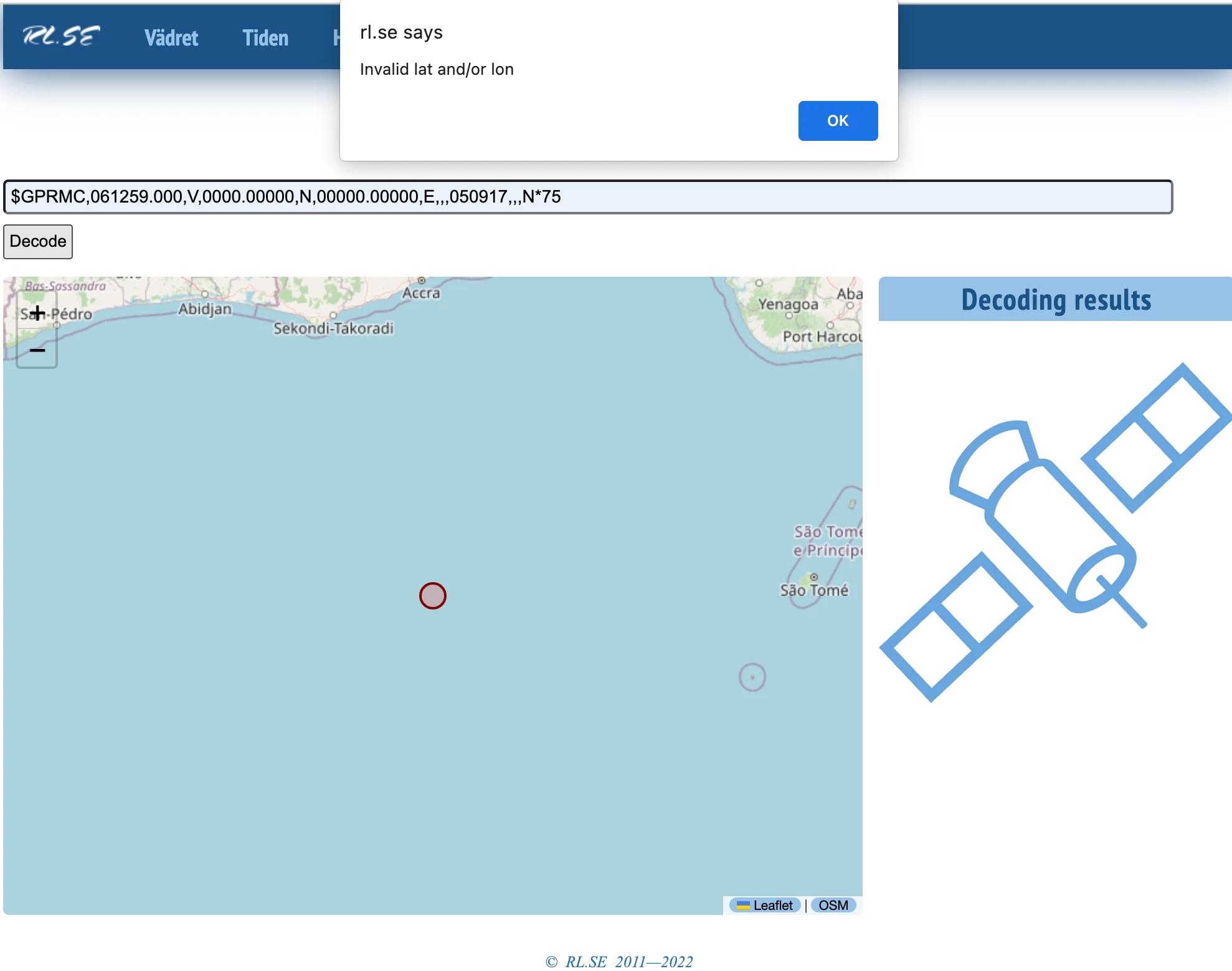

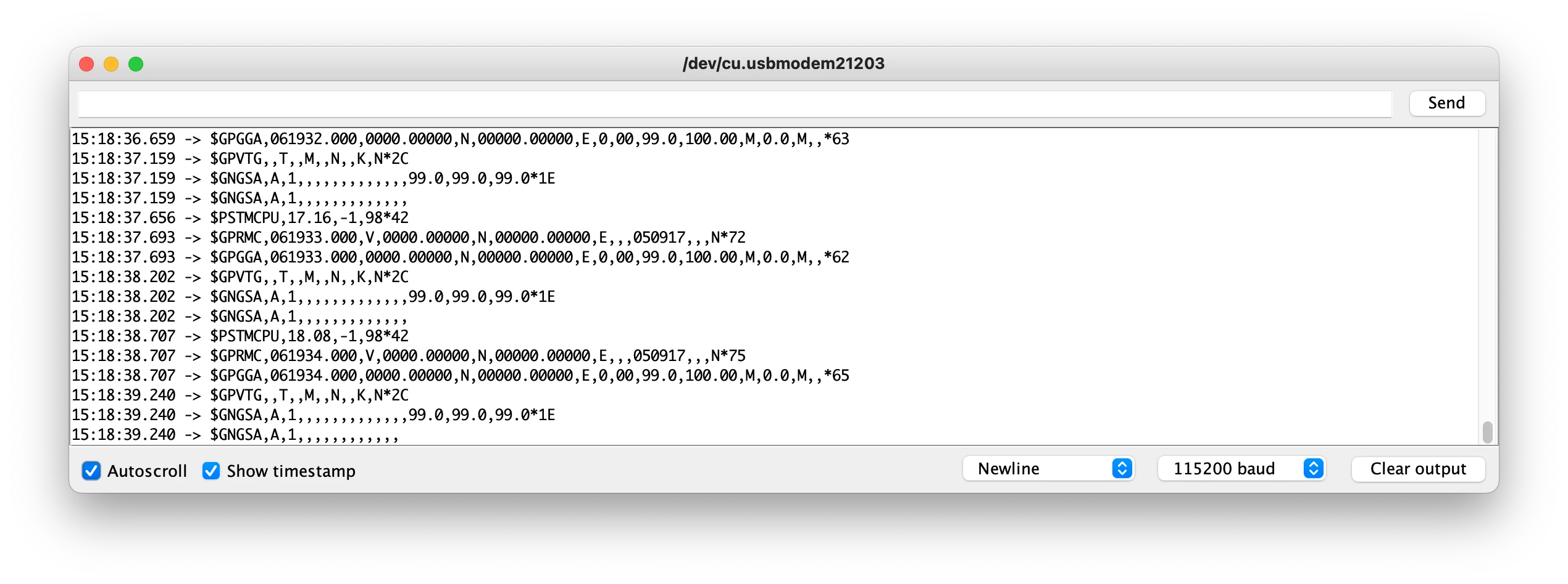

I'm planning to make a GPS tracker using  Teseo LIV3FL as a slave device and STM32 Nucle-WL55JC1 MCU with I2C communication protocol. The I2C reading is working (I assumed it works since I'm receiveing some data), but the problem is when I take one of the reading and decode it using a GPGGA (or similar) decoder it says I got an invalid data.
Serial monitor
0693W00000WJxBiQAL.pngDecoded data
0693W00000WJxBnQAL.pngAnd code snippet for sensor reading

It flags that it doesn't have a solution, and you use it anyway.
Suggests the antenna or RF side is not working properly, should be outside with a clear view of the sky. Expect in to take around 30 to 40 seconds to get an initial fix in ideal conditions. ​

Ahhh turns out the solder connection between the antenna and modules isn't good. Thanks!
