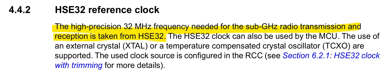

I am designing an Outdoor Radio product with STM32WLE5CBU6. my question is whether the Internal RC Oscillator is enough for my radio applications ? or do I need to add External TCXO in my circuit considering the outdoor temperature environment? for my product cost-cutting. please suggest.

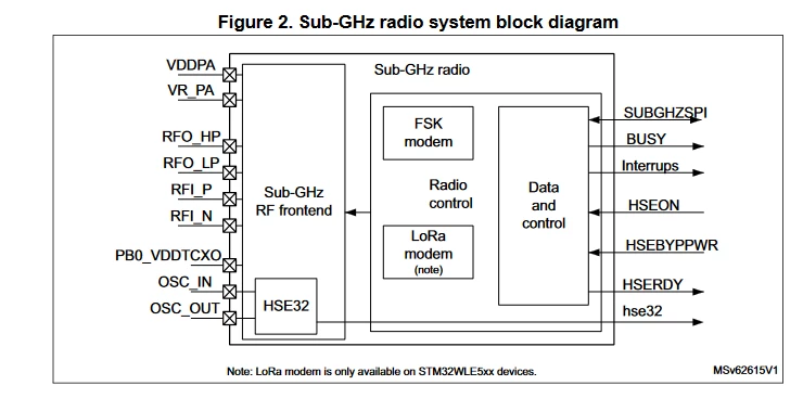

Usually you want/need for GHz or many-MHz PLL a very stable clock source, typical a crystal.
See basic:
HSE32 is the "standard" clock for the PLL. (If 20 ct for a crystal is too much, you have another problem...)

TDKBest answer
Jul 17, 2024 12:59 PM UTC
It needs an external crystal to have wireless transmission capability.
