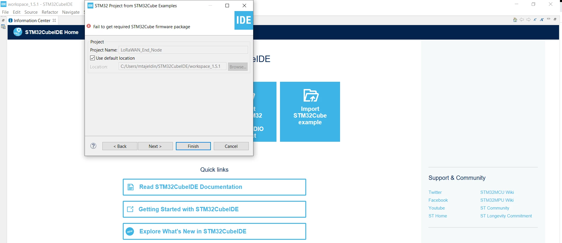

Installing STM32 Firmware for Nucleo-64 Board - LoRaWAN Example
I tried to open and test a LoRaWAN example for the STM32WL, Nucleo-6344 board but it returned an error message shown in the attachment.
Can you advise, please?
Thanks,
Mohammed

Check the repository setting, ie directory/folder involved, user rights, presence of correct Cube libraries for the part

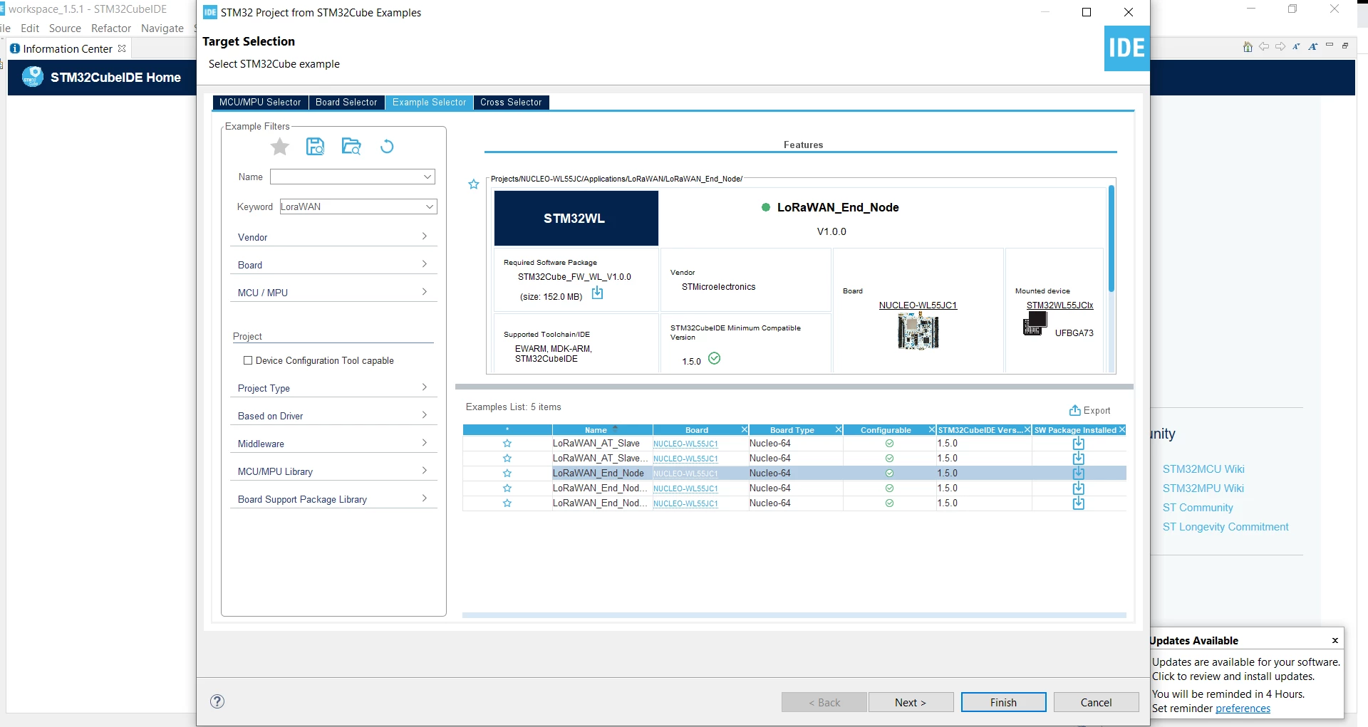

Hi MTaj-.1,
Can you please provide the STM32CubeIDE version you are working with?
I tried with STM32CubeIDE V1.5.0 and STM32CubeMX V6.1.1 and I had have no problem, the package was perfectly generated.

Hi Ons,
I am using the lastest version (STM32CubeIDE Version: 1.5.1 Build: 9029_20201210_1234 (UTC)).

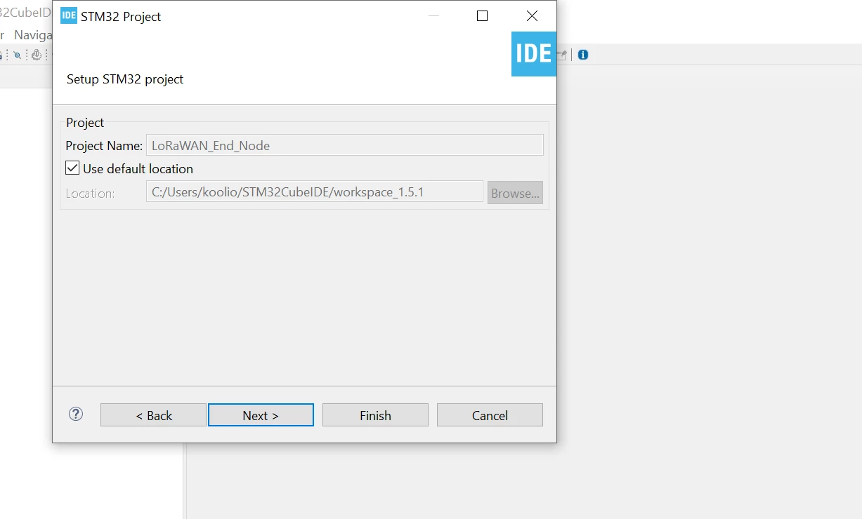

Hi Mohammed,
I have no issue also with STM32CubeIDE Version: 1.5.1 Build: 9029_20201210_1234 (UTC)
0693W000008yahDQAQ.pngIf you still have the same issue thank you to mention this, or mark this question as answered by checking Select as Best answer.
