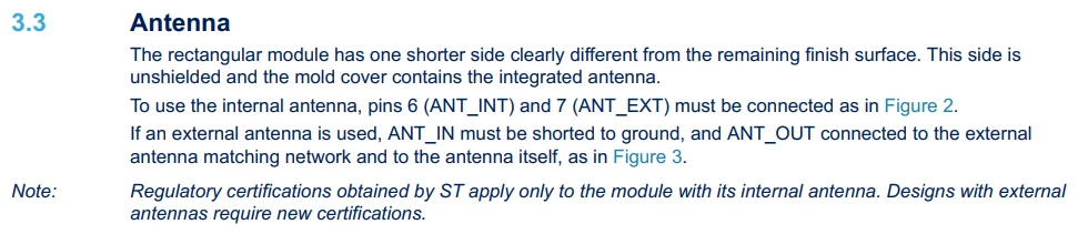

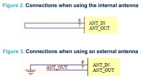

I'm in the process of developing a device using the STM32WB5MMG, and I have a query regarding the wireless testing method for the final product.
I need to conduct tests using an antenna (external antenna) approved by the certification body rather than utilizing the built-in antenna on the MCU.
Could you please confirm if there is an option similar to STM32WB1MMC where external/internal antenna selection is available, or if there is a method to use an external antenna?
I have attached the antenna options section from the datasheet of STM32WB1MMC for reference.
Thank you.

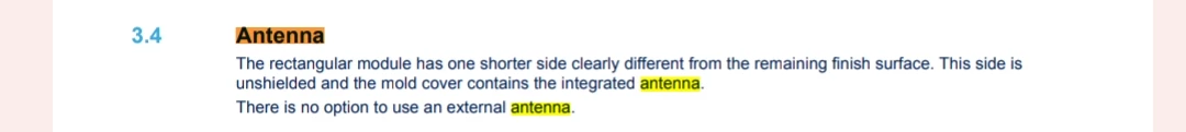

Hello @KWOOJ
As indicated on the part 3.4 of the DS13252, There is no option to use an external antenna:
Best Regards.

I have one more question, Is there any way to remove the internal antenna?
STTwo-32
Mar 25, 2024 7:31 AM UTC
the internal antenna is integrated on the design. so, it is not possible to remove it.
Best regards.
