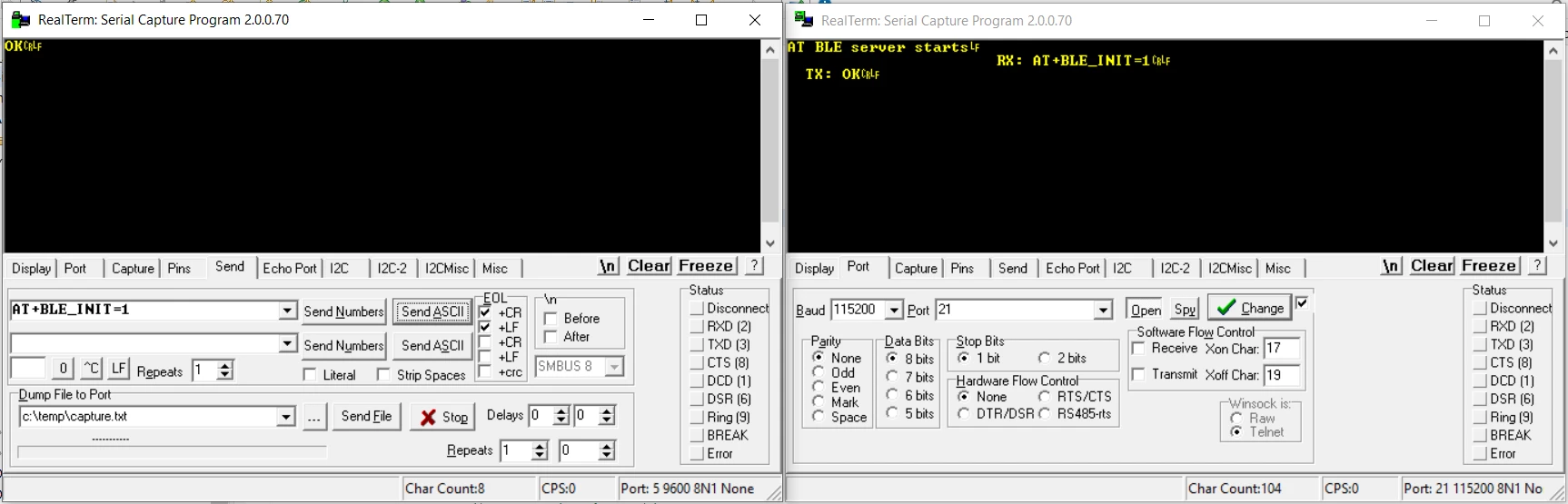

I try to learn about Bluetooth communication with STM32WB15 but it doesn't have AT server firmware so I try to design my own firmware base on STM32L412 UART communication and STM32WB15 with transparent mode firmware.

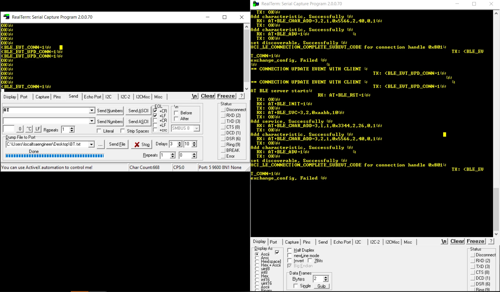

Hi @KDJEM.1​, Thanks for answer, Is the other way to road. For now, we found the AT+SERVER firmware application for P-NUCLEO55 (MB1355C-02), I think we can migrate the code for STM32WB15 but the firmware not work good. For example, I can create the server but when I try to connnect my smartphone to this server, P-NUCLEO55 is freeze...
BTW, I was change the stack because all of them working different... now, I try to work with light_stack from 1.13 version.
someone have the same problem with this firmware?
