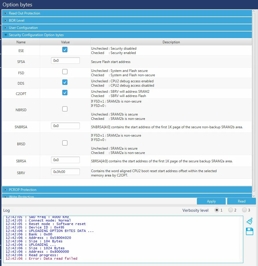

Incorrect option bytes setting has blocked FLASH, how to unlock FLASH
HI all,
I tried change option bytes for STM32WB55 in code, and probably something went wrong when I did this. After programming MCU I found that my flash was probably be blocked:
How can I unblock FLASH? I tried change security config options in STM32CubeProgrammer, used CLI, used DFU mode but It didn not help. In all the time I have error:
STM32_Programmer_CLI -c port=swd -ob SFSA=0xcb

OPTION BYTE PROGRAMMING VERIFICATION:
Error: Expected value for Option Byte "sfsa": 0xCB, found: 0x0
Error: Option Byte Programming failed

Can you still access the option byte ad dtry to set the watchdog option back to its original value.
Then try
  1. STM32_Programmer_CLI -c port=swd -w32 0x5800040c 0x00008000
The SFSA value should revert to 0xF4 with all the user memory erased of any previous FW.

SFSA cannot be modified by the application being a code running on the M4 core or a command sent from the CubeProgrammer tool.
This is a secure option byte. Any trial to modify it triggers a safeguard action blocking all accesses to the flash memory and protecting the complete flash area by setting the SFSA option byte to 0.
The only way to recover (if and only if the FUS version the chip is V1.1.0) is to write the value 0x00008000 (instead of 0) at the address 0x5800040c. This will reset the device to its manufactory state: A clear flash memory.

Trying to modify any of the secure option byte will end with the same result: a completely protected flash memory.

I treied change this bit after flash was blocked, before I didnot change any security/protect bit.
My MCU has FUS version the chip is V1.2.0 - how clearig flash memory in this wersion ?

Unfortunately, this does not work with V1.0.2. V1.1.0 was released to support this roll back to the manufactory state.
I am afraid there is no way to unblock your board.
