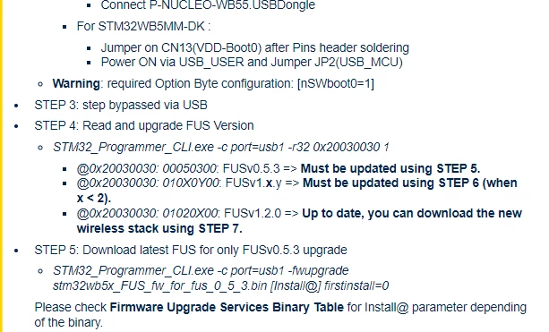

In STM32 using USB1 as an interface, when I flash the FUS version and BLE stack for the first time it is able to flash, but when I repeat the same steps then am not able to read the FUS version. Can anyone help me with this issue?
The steps performed:
  1. First read the FUS version.
  2. Selected the FUS bin file to flash.
  3. Flashed the above-mentioned file.
  4. Then again when I read the FUS version it was displaying as 00000000 in GUI

_legacyfs_online_stmicro_images_0693W00000bhdrmQAA.pngAs per STEP 4, the FUS version should have been read irrespective of anything, but when I erased the chip completely am not able to read the FUS version via USB.

Right now the chip has been erased completely.
Do you know how to enable the cortex M0+ before reading the FUS version via USB?
Mkuma.7
Mkuma.7Author
Apr 10, 2023 1:28 PM UTC
Or In other way of asking, Is there any way to start FUS without making the nswboot0 = 0 via USB?

I tried to reproduce your issue, but I don't see it.
  1. Connect to STM32CubeProgrammer through USB
  2. Read FUS => v1.2.0.0
  3. Firmware Upgrade with FUS fw v1.2.0.0
  4. Reconnect through USB
  5. Read FUS => v1.2.0.0
I'm using STM32CubeProgrammer v1.13.0.
