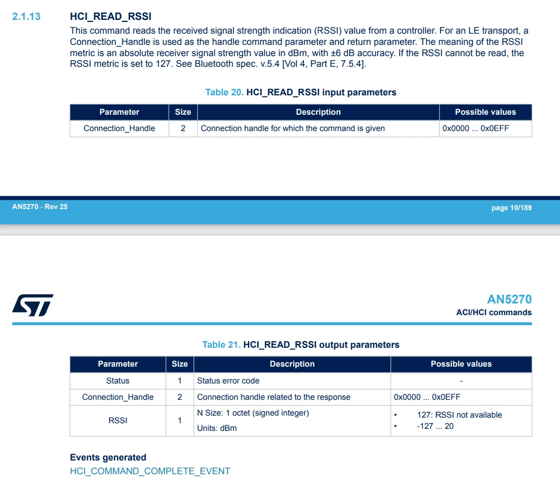

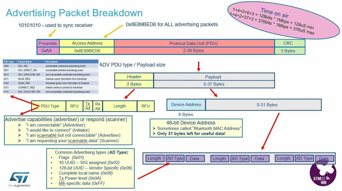

Hello @Kavinraj
The RSSI is part of the advertising packet received from the BLE stack. The RSSI is the Tx Power level. You can check the AD type and the RSSI value is the data next to it. You can also read this information using the command HCI_READ_RSSI.

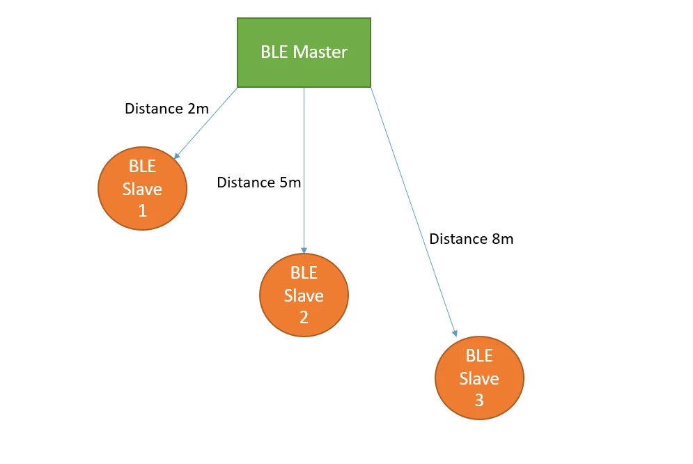

Hello @STTwo-32 ,
     I want to get distance of BLE Slave devices(CLIENT) using RSSI value. In this case i have doubt about to use STM32 Master as a BLE Server or BLE Beacon.
Here attaching sample model of our project objective.
STTwo-32
May 20, 2024 6:24 PM UTC
Hello @Kavinraj
The RSSI is a parameter that may help you to estimate the distance. But, On BLE Technologie you need to have a direct Line of site to have a good estimation of the distance. I suggest you measure different distance and collect the RSSI of each distance then you can create a mathematical equation that receive the RSSI as input and calculate the distance. Then, using the triangulation Methode (3 node fixe), you can estimate the exact location of each node. The Serial Trace need to be implemented to visualize the data.
