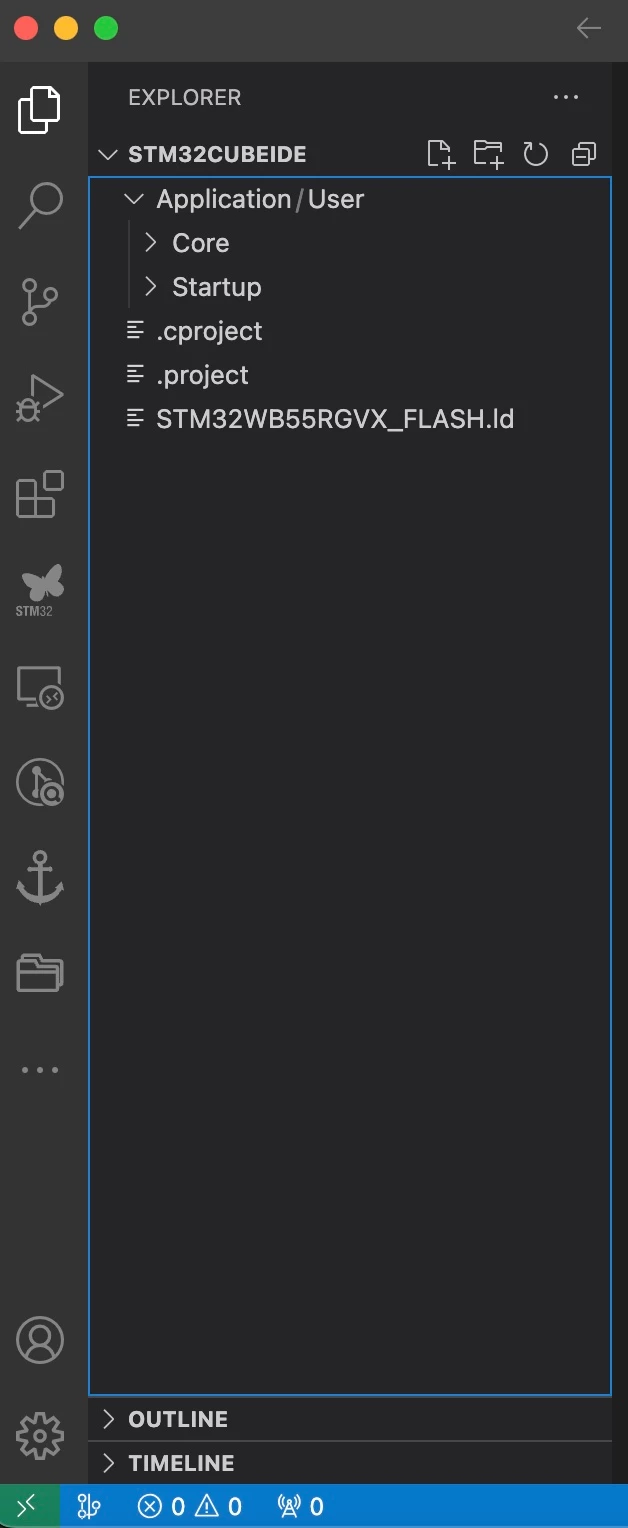

    Mar 19, 2024 6:46 AM UTC
    If I try exactly as you say:
    Step 1: Open Vs Code into the "STM32CubeIDE" version of the project
    Open folder, succes.
    Step 2: Try to "Import a local project" and select the project.ioc
    Fails at this point. After opening up the folder stm32cubeide in the ble heart test example folder, I go to the stm32 extension. Choose import a local project and go one folder up to select ble_heartrate.ioc
    The returning error: Project importing failed. ENOENT: no such file or directory, open '/Users/remyhurx/Documents/STM/Library/STM_Firmware/STM32CubeWB/Projects/P-NUCLEO-WB55.Nucleo/Applications/BLE/BLE_HeartRate/.project'
    This file is in the already opened folder, but it doesn’t read. So it fails before I can do step 3 etc.
    I tried to add the higher folder (with the.ioc) to the workspace, with the same result. So I didn’t had the chance yet to do step 3 or 4.
