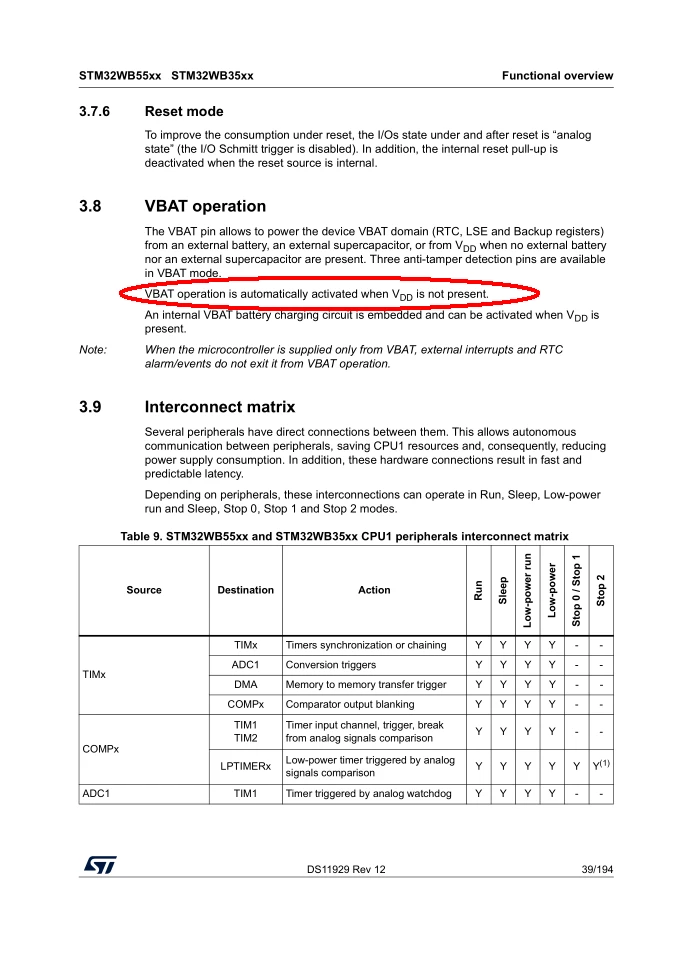

If the power is cut, is the micro controller use battery power automatically?
I'm developing STM32WB55VQ power system but I wonder the microcontroller automatically use battery power or not when Vdd is cut.
Is there anybody can explain this?

again, that's all answered in the datasheet.
 From your other Thread:

waclawek.jan
Jul 6, 2022 7:17 PM UTC
VBAT pin supplies only RTC.
Read an answer Andrew's questions above.
There's no provision to switch between different VDD sources, and they must not exceed voltages given in DS. Design of VDD power source is entirely upon you.

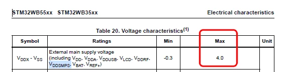

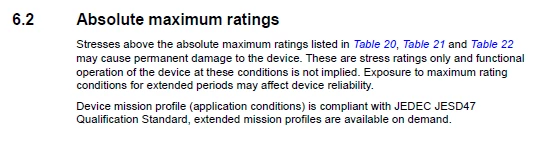

I wonder what's happen if apply more than 4 V.​
Andrew Neil
Jul 7, 2022 2:07 PM UTC
Again, the datasheet tells you that.
The 4V is the Absolute Maximum rating; the datasheet defines that term:
