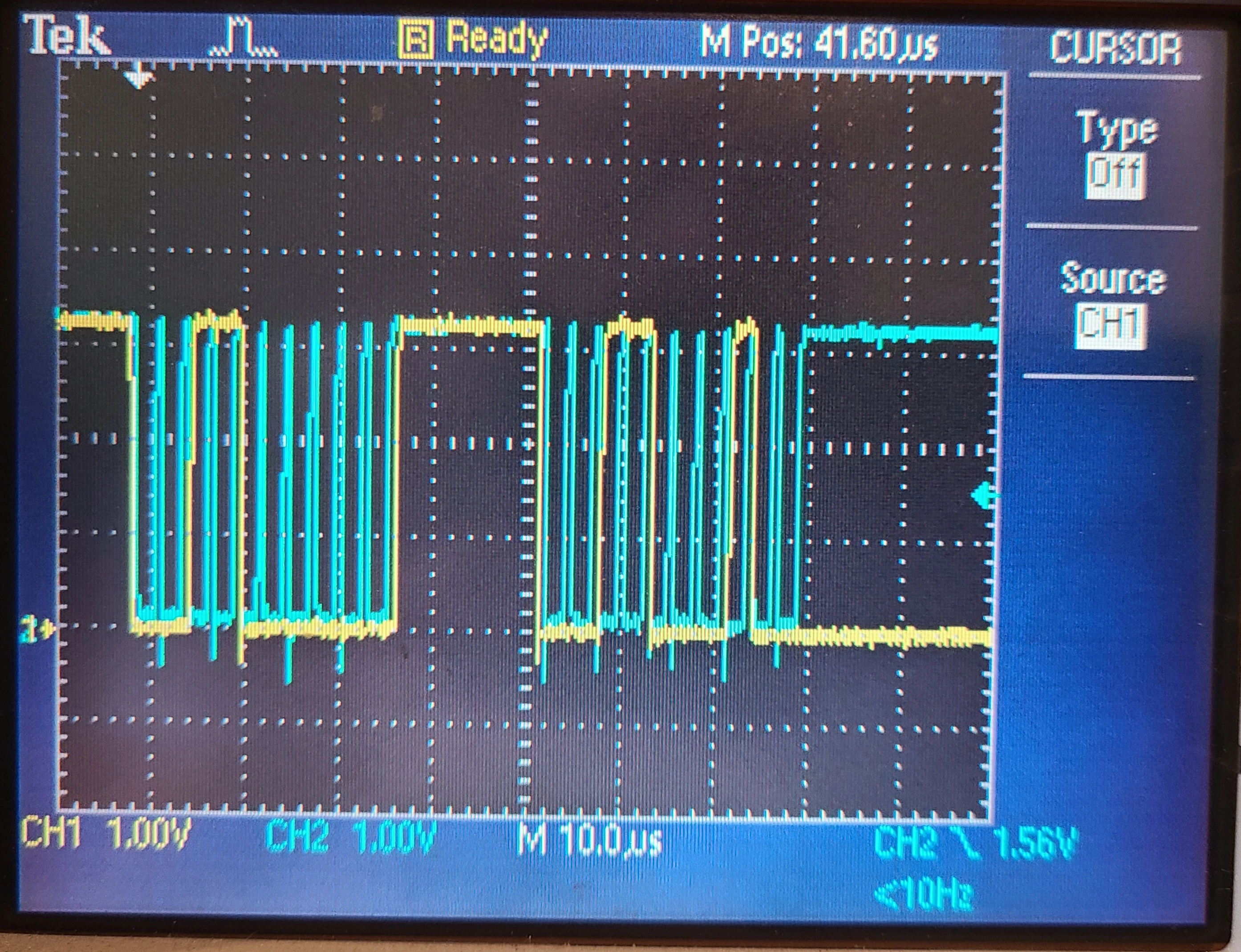

I have an STM32WB design using I2C to get 6 bytes from a BMI0888 every 50ms (triggered by an external interrupt).  The interrupt sets a flag in my main loop to go get the data.  The devices first requires you to write the desired register, then read the 6 bytes.  If I use back to back calls to HAL_I2C_Master_Transmit followed by HAL_I2C_Master_Receive, it works great.  See figure 1 below.  That will happen every 50ms.

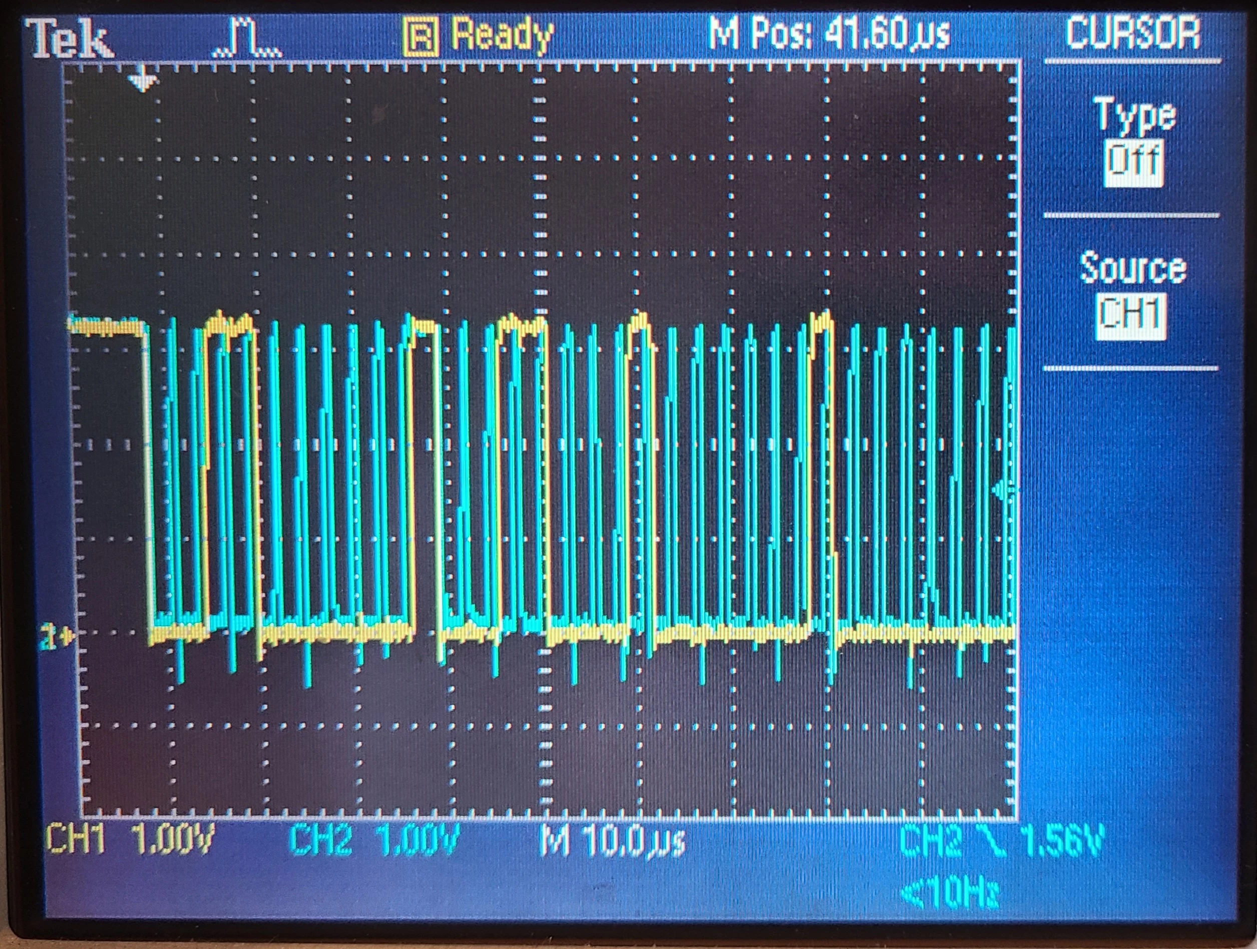

I am now trying to do this using the interrupt versions of the functions.  If I try and use HAL_I2C_Master_Transmit_IT and HAL_I2C_Master_Transmit_IT.  I again use flags to inform my main loop what to do.  The external interrupt flags the loop to perform the transmit, then the HAL_I2C_MasterTxCpltCallback informs the main loop to perform the receive, and then HAL_I2C_MasterRxCpltCallback tells the main loop the data is ready.  I get all of these interrupts, however the data isn't actually read.  See figure 2 below where SCL stops high.

 When this is called the device will transfer the slave address and then receive the first 2-bytes but NOT the last ack.  At which point the clock goes low.  It stays low forever.

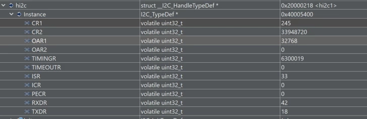

This interrupt will fire 6 times, each time running the code above, but scl stays low.  On the 6-th call the I2C_ITMasterCplt function is called because it thinks the transfer is done.
At this point the registers are.  I don't see any errors here, and I see a stopf.  Again, scl is still low and the last 4 bytes are never actually clocked:

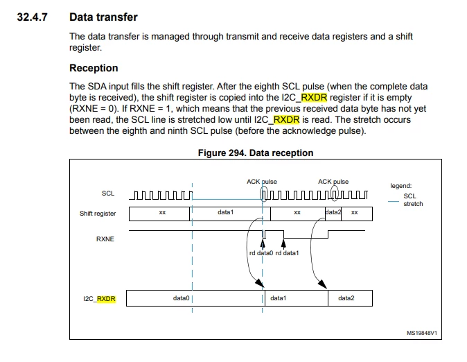

Feb 8, 2024 11:17 PM UTC
The manual describes this exact behavior is RXDR isn't read.  Specifically that SCL will stretch between and 8th and 9th bit.  However I am seeing the callback in the hal read from RXDR yet nothing happens on the line:
