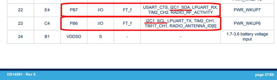

I'm developing a BLE device using the STM32WB05 that supports I2C and BLE connections.
I successfully established an I2C connection using I2C_SCL(PB6) and I2C_SDA(PB7).
However, PB7 is used for RADIO_RF_ACTIVITY on BLE, causing a conflict between BLE and I2C.
Therefore, I tried changing to I2C_SCL(PA0) and I2C_SDA(PB14) to connect to the I2C master, but the connection failed.
I'm wondering if the I2C pins on the STM32WB0 are limited to only PB6 and PB7.

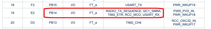

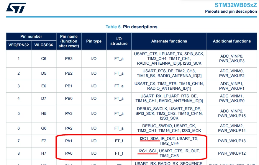

According to the table 6, table 7 and table 8 of the DS14591,  I2C1_SDA and I2C_SCL are available on PA0, PB6 for I2C1_SDA and PA1, PB7 for I2C_SCL. The PB14 is used for I2C1_SMBA signal.

As @STTwo-32 said, There is no I2C_SDA on PB14:
You need PA0 and PA1:
