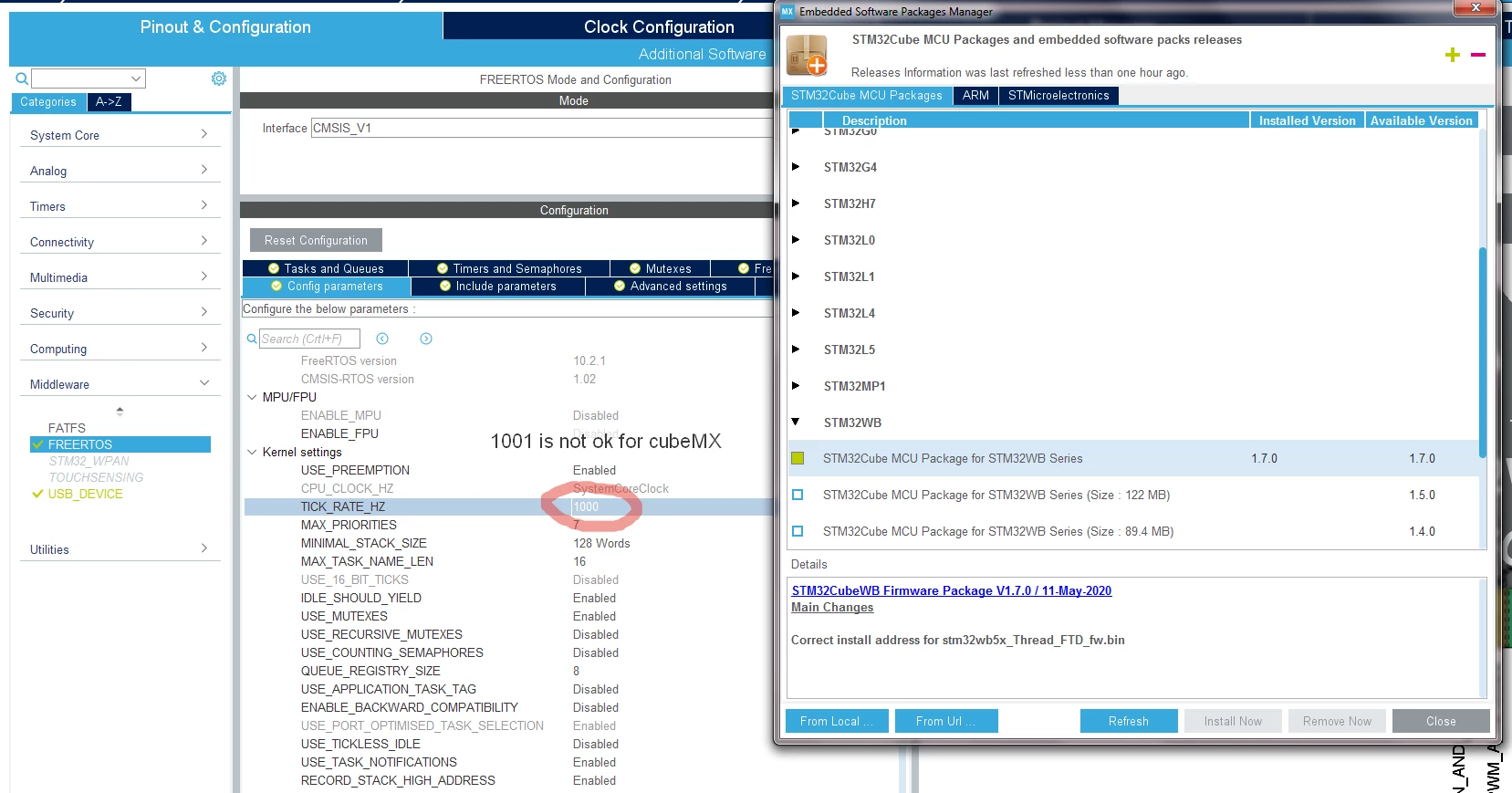

I use STM32WB55 with Cube MCU Package 1.7. I can't set configTICK_RATE_HZ of FreeRTOS more than 1000.

CubeMX just truncate my const to set 1000. CubeIDE is the same.

If this is because HAL_SYSTICK_Config(HAL_RCC_GetHCLKFreq()/1000); Cube should issue a warning, not just truncate.
