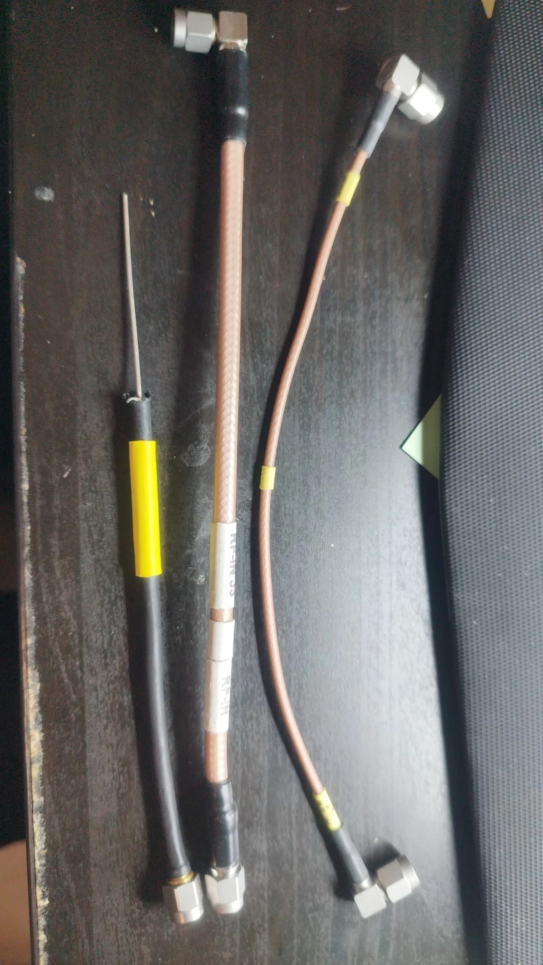

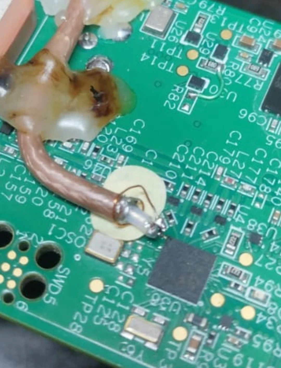

I'm recieiving wrong dbm value on STM32WL can you help? urgently?
we are strugling in our project that is now in a trial with the customer and I need your tech support to provide the information on the way to increase the TX power to maximum. We are now seeing a -30dbm directly from the  STM32WLE5JCI6 pinout RFO_HP.
Please advise the correct way to enable the maximum output power.
See below the drawing, we are connecting directly to measure the power
I'm using coax cable via spectrum analyzer to measure it. what am I doing wrong?

Jun 12, 2023 7:54 PM UTC
For urgent help work with your FAE out of your local ST office, and those responsible for your account.
Should provide some insight into the registers of the LoRa portion of the device
https://cdn.sparkfun.com/assets/6/b/5/1/4/SX1262_datasheet.pdf
Make sure the right output is selected, power setting, and current limits.
