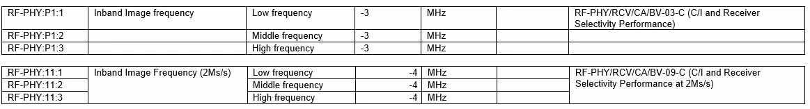

I'm doing Bluetooth SIG qualification on STM32WB55RG and need to know the the following IXIT /PIXIT Inband Image frequency for 1Ms/s and 2 Ms/s RF-PHY:P1:1 to 3 RF-PHY:11:1 to 3 can you please let me have them? thanks

Here are the values for 1 and 2  Ms/s0693W000008GHPWQA4.jpg

Great, thanks for this @Remi QUINTIN​ , is there a document that has these and other PIXIT / IXIT parameters specified?

Informations regarding the frequency are in the Datasheet ( Table 28. RF receiver BLE characteristics (1 Mbps) & Table 29. RF receiver BLE characteristics (2 Mbps) ).
All IXIT informations that descrive how the certification is performed are in the official certification report (see Appendic C in the joint document).
