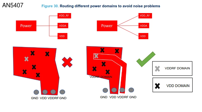

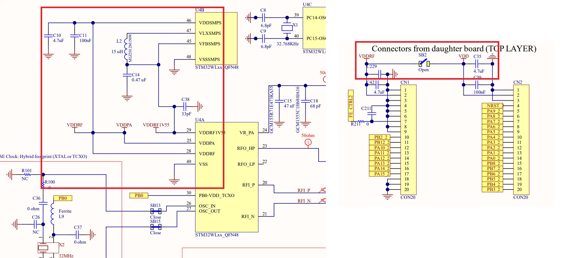

I tried to design a board using the STM32WLE5CCU6, so I referred to the reference designs MB1720,1842,1848, etc.
However, I confirmed that the VDDRF part, which is the part specified in the data sheet, is open with the SB connector.
I searched for the reason why this happened, but I couldn't figure it out, so I'm looking for help in this community.
Why are VDDRF and VDD disconnected?

Check the AN5407, it's very annoying to work with RF.
