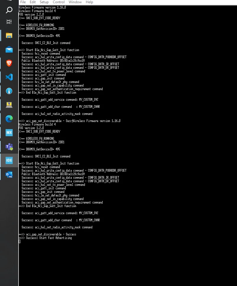

dnj
dnjAuthor
May 25, 2023 11:52 AM UTC
Maybe, I didn't say it clear. I have to unplug my STM32 WB55 Dongle, plug it again to USB PC and then attach debuger. If I do it in other way I cannot see on ST BLE Toolbox my device.
It is log from ST BLE debug trace after click "Debug".
dnj
dnjAuthor
May 25, 2023 11:53 AM UTC
As you can see, it initalizes stack twice. Once before get to "HAL_Init();" breakpoint and after that.

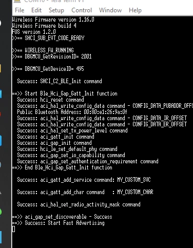

dnj
dnjAuthor
May 25, 2023 11:58 AM UTC
If I unplug and plug it again I can see only one stack initialization. Picture below.
