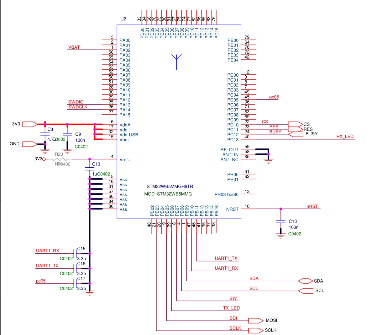

PPREN.1
Jun 8, 2022 9:30 AM UTC
Hi Maxim,
I would be very happy to help you but I am not sure I will with this answer: not reproducing the error since not exactly the same setup at my side, hence only "ideas" (that you certainly already had in this message.
It is very easy to have a leakage current in a pad not configured the right way. Even pull up or pull down are needed to be setup accordingly to WB part and schematic. It is also easy to "shift" from an application that has "low conso" to another "state" where the conso is higher (let's take an example, when you are re-using a timer that is trigged after 10 minutes, and it is "killing" your nicely "low conso" application.
Hence...
>1) Is it really possible to get down to 3uAmp? What shall I do? Is there any instruction? I have tried everything I could.
--> I would say yes, with the appropriate schematic, with the appropriate application similar to OnOff_SED + Coord, you will get 3 uA (and a bit more depending on the frequency of exiting the stop2 mode that are mainly done with those 2 lines in P-NUCLEO-WB55.Nucleo\Applications\Zigbee\Zigbee_OnOff_Client_SED\STM32_WPAN\Appapp_zigbee.c :
   UTIL_LPM_SetStopMode(1U << CFG_LPM_APP, UTIL_LPM_ENABLE);
   UTIL_LPM_SetOffMode(1U << CFG_LPM_APP, UTIL_LPM_DISABLE);
My advice is only to review step by step your code. To get a simplified code that is doing the STOP2 mode and with this basic "SED always sleepy like" application, investigate why you are not getting it.
I guess ST has provided the schematic of the nucleo board as well as the packaged used (being STM32WBRG = 64 pins)
and the module STM32WB55M-CSP100 or STM32WB55M-QFN68 : here, I am not sure... can you add the schematic in the ticket and WB exact package?
>2) Why there is a difference in the current consumption when connection to different ZigBee hubs (Zigbee_OnOff_Server_Coord vs *****)?
--> I don't know. My guess is that the commissioning was not done, hence, going to 3 uA is never happening. To simplify, the 4 steps of a SED: step1:network search, step2: network commissioning step3: sleepy SED STPO 2 mode step4: SED not sleepy, waking up with a low power timer and doing stuff before going back to STOP2 at the end.
Please, don't hesitate to add additional info / answer / or questions if this answer is not complete (or to open a new question, to be aligned between the title and the question).

Maxim Shylo
Jun 8, 2022 10:25 AM UTC
Hi Pascal,
Thank you for your replay.
As you asked, I provide a schematic of the device.
There is nothing there but the module STM32WB5MMGH6TR.
Kind Regards,
