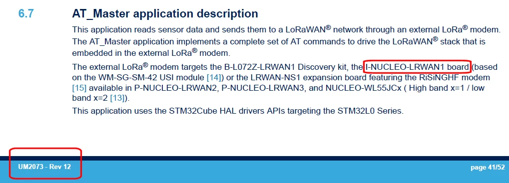

 I-NUCLEO-LRWAN1 has the USI module - this is, effectively, a modem with an AT Command interface.
Therefore the project you need is:
Projects\NUCLEO-L073RZ\Applications\LoRaWAN\LoRaWAN_AT_Master
See section 6.7 of the User Manual:
EDIT
Ah - you wanted the NUCLEO-L476RG. It seems the AT_Master is only provided for the L072 and L053 - so you'll have to do some porting for the L476 ...
