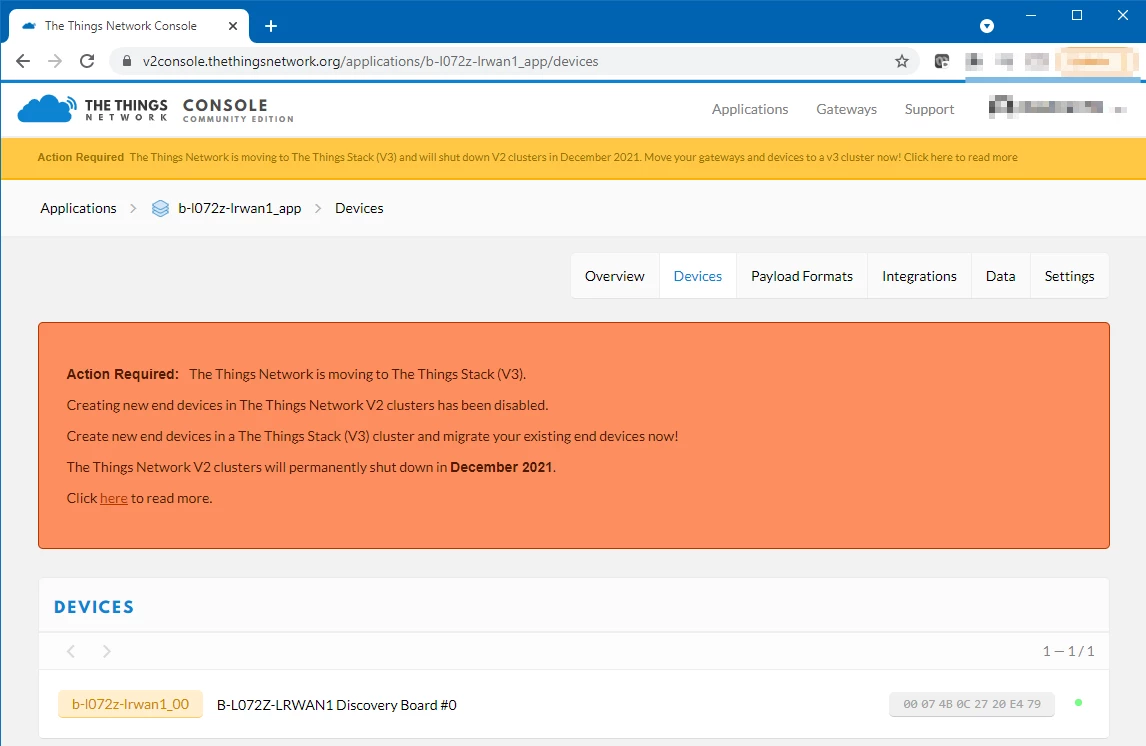

I-Cube-LRWAN - The Things Stack (V3) replaces The Things Network (V2)
  • July 6, 2021
  • 11 replies
  • 5844 views
What was known as "The Things Network" (TTN) is now "legacy" and not accepting any new devices, gateways, or applications.
Thus, I think, all ST materials referencing "The Things Network" are now obsolete & unusable.
So, has anyone managed to migrate anything based on I-Cube-LRWAN to the new "Things Stack" aka "V3" ?

A lot of other material besides STM32 is obsolete as well, transition has not been seamless. I can't say much for I-Cube-LRWAN, but the STM32WLE examples/package can be made to work on the new TTN stack. The new stack does require you to enter more information about your application, including the LoRaWAN MAC version. Finding this part out can be tricky, but I found it to be V1.0.3 for the STM32WLE.
Other than this and some other extra info, the connection between your device and the TTN server should still be largely the same, so hopefully you can get your old application to work with some minor tweaks in the application. Make sure to use the verbose output in the live data view.

In the TTNv3, "Register End Device" requires to define the LoRaWAN version (as already stated by @moatjon​ :( You need to choose the v1.0.3 if your devices are based on I-CUBE-LRWAN v1.3.1, I-CUBE-LRWAN v2.0.0 or STM32CubeWL v1.0.0 deliveries.
The ST LoRAWAN stack is an integration of the Semtech stack in using these specifications:
Therefore, STM32's LoRaWAN devices are not obsolete with TTNv3. Follow this link to migrate your devices from TTNv2 to the new Database of TTNv3: https://www.thethingsnetwork.org/docs/the-things-stack/migrate-to-v3/migrate-using-console/
If this is still not enough to make your nodes work properly with TTN, please let me know.
