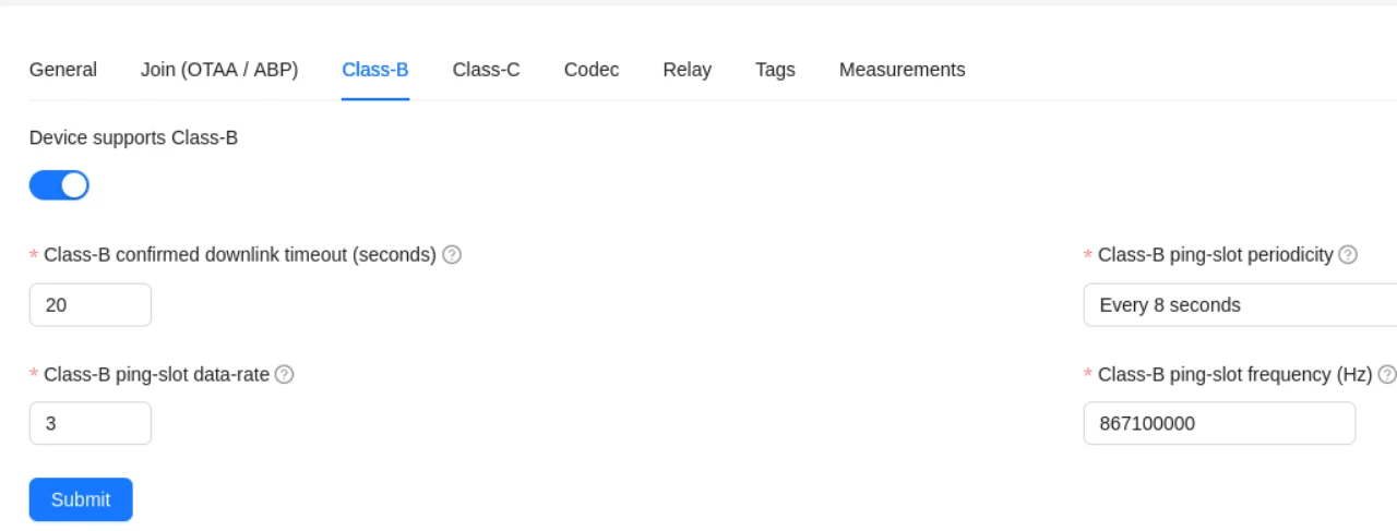

Hi everyone,
I'm working with an STM32 B-L072Z-LRWAN1 board and a Lorank8 gateway (Beaglebone + iC880a concentrator), using the I-CUBE-LRWAN expansion software package.
I have successfully implemented Class A and Class C with Chirpstack and TTN, but I’m facing issues with Class B: I cannot receive any beacons at all.
This is what I get in the end-device logs:
###### ========== MCPS-Confirm =============
1742226431s914:RX_BC on freq 869525000 Hz at DR 3
1742226432s132:MAC rxTimeOut
It seems that the device is trying to listen for beacons, but it never receives one.
This is the gateway log:

And my Chirpstack config:
Has anyone encountered this issue before? Could this be a problem with my gateway configuration, or am I missing something in my end-device setup?
Any help or suggestions would be greatly appreciated!
