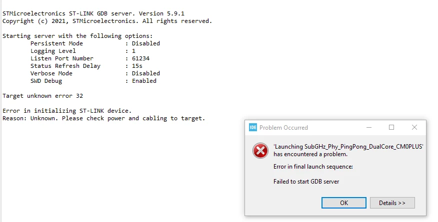

I have no problem to flash or debug the CM4 of the board. But when I'm trying to flash the CM0+ this error occurred :
Error in final launch sequence:
Failed to start GDB server
Error in initializing ST-LINK device.
Reason: (255) Unknown. Please check power and cabling to target.
This informations are show on the consol :
STMicroelectronics ST-LINK GDB server. Version 5.9.1
Copyright (c) 2021, STMicroelectronics. All rights reserved.
Starting server with the following options:
    Persistent Mode      : Disabled
    Logging Level       : 1
    Listen Port Number     : 61234
    Status Refresh Delay    : 15s
    Verbose Mode        : Disabled
    SWD Debug         : Enabled
Target unknown error 19
Reason: Unknown. Please check power and cabling to target.

There is an incompatibility with STM32CubeIDE v1.9.0, and the STM32Cube_FW_WL_V1.2.0 so I suggest you to use the STM32CubeIDE v1.8.0 version to debug a dual core project.

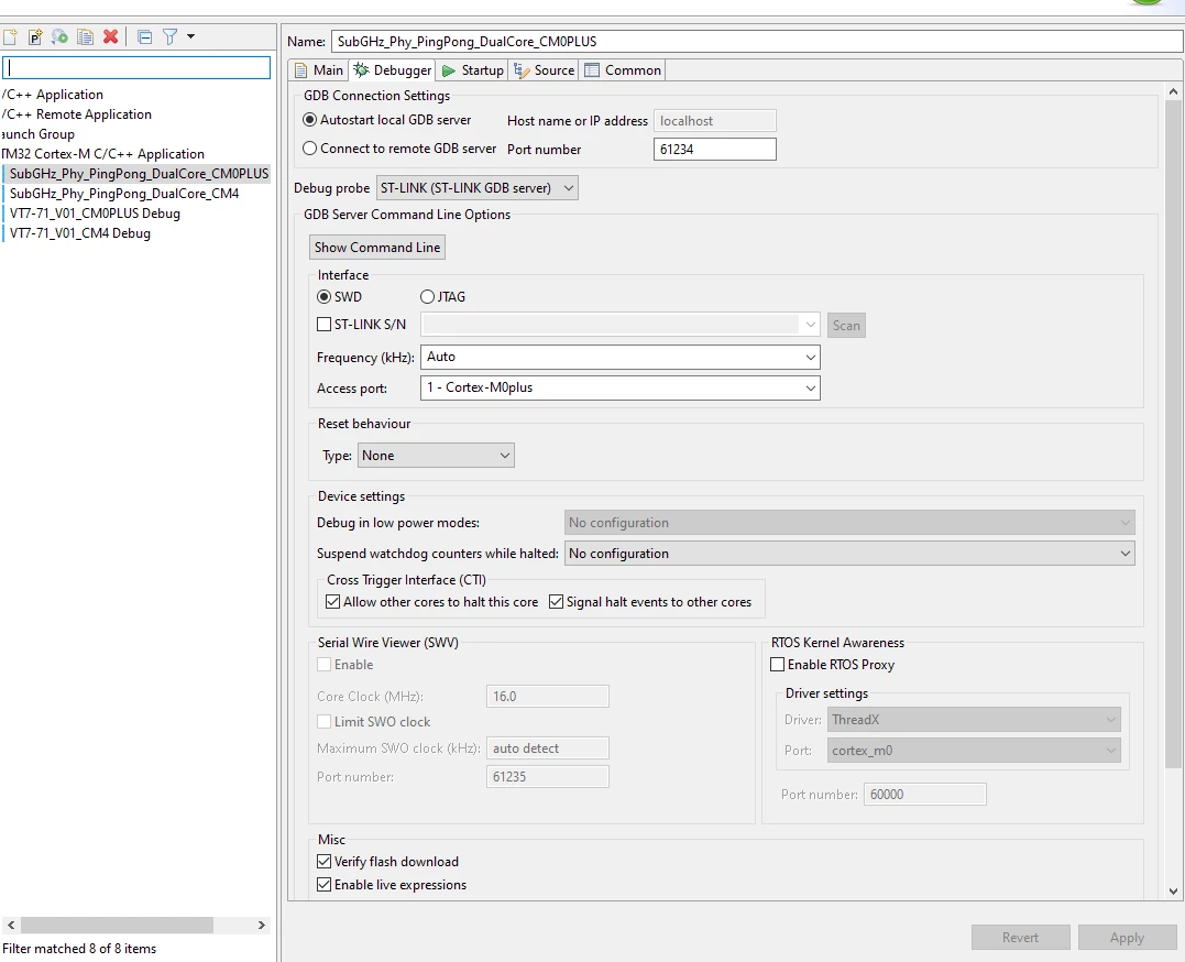

I see in HPERNET comment, the listen port number if not right, for the CM4 it is set to 61234, and for the CM0PLUS it have to be increased at least by 3. I use 61238 and it works well on my side.
You can refer to the AN5564, Figure 10. ST-LINK GDB server debug configuration (5 of 6), it is specified just above that you need to increased the port number at least by 3.
We are working on this issue with STM32CubeIDE v1.9.0, and we will let you know when we have a fix. In the meantime, please use STM32CubeIDE v1.8.0.

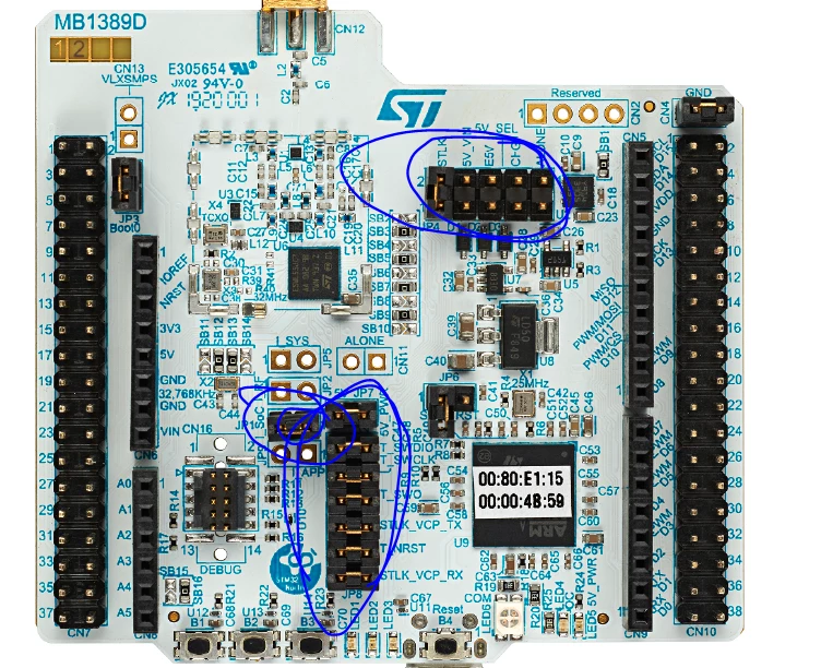

did you removed or changed any of this jumpers?
How do you know if the board is not broken?

I just tried to connect those pin like its show on this picture (following the youtube tutoriel of STMicroelctronic https://www.youtube.com/watch?v=bt_A0JO7E_8)

I have this configuration :
Is anyone have an idea about why I cant flash my MO+ ?
Or do you have some ressources that I can use to make my configuration ?
