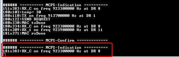

I can't receive a message downlink immediately in LoraWAN Class C.
hello there
I am useing stm32L496 with SX1262DVK1DAS lora module.
As firmware, I am using the latest firmeware I-CUBE-LRWAN 2.1.0
As lorwan server is am useing public lorawan network.
I am testing my device with CLASS_A and CLASS_C modes.

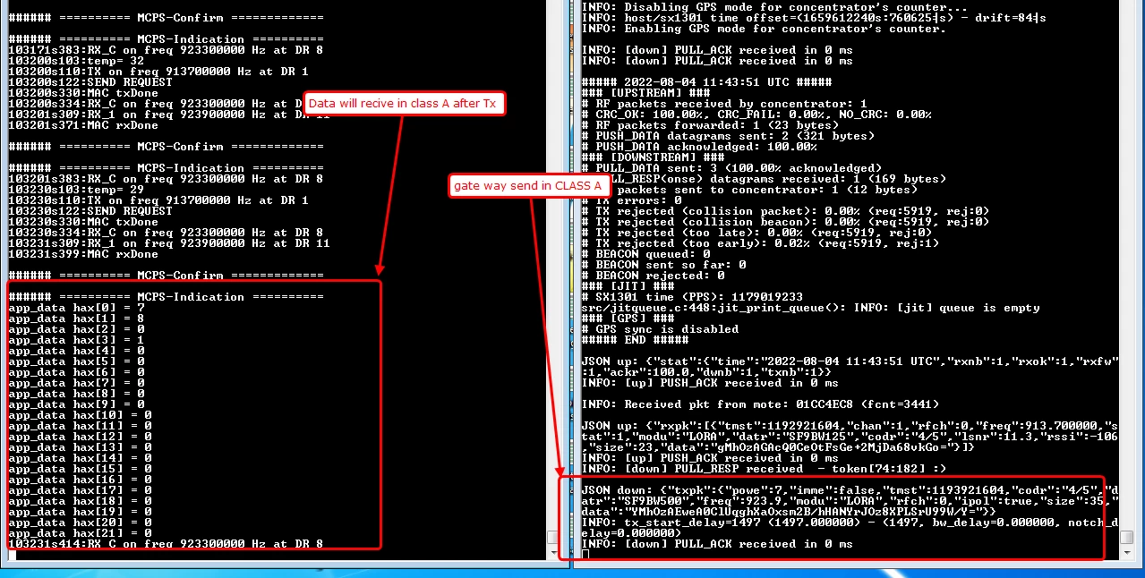

when is sent data on my module via class A it works.
In CLASS_C I expect an immediate response because the RX window is always open in class C.
In my log, I observe that my RX window is open after TX.

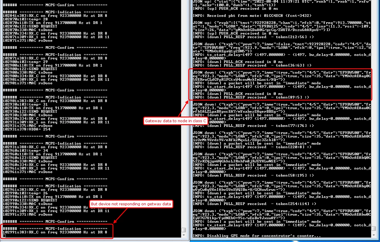

when is sent data on my module via class C it's not working.
I also debug my getaway it works fine with classes A and C.
But my node does not receive data on class C.
Are there any parameters we Rely on in class C please suggest what I am missing.
please suggest me.

My node's CLASS_C Rx window will be open but I didn't get any response from the controller side. but in getaway send data to node successfully.
In CLASS_A. data received in the gateway to the node.
In CLASS_C. data not received in the gateway to the node.
I am confused because my device works fine with CLASS A but does not work with CLASS C
Thank you for providing a resource.
I am familiar with these things and according to the above resources.
As per the network server, I am also using https://gotthardp.github.io/lorawan-server.
when I configure Node with CLASS_A. bi-direction communication with node to "https://gotthardp.github.io/lorawan-server" works fine.
In CLASS_C my node will successfully data transmit to the server but I am not able to receive data from server to node.
So I need suggestions on which configuration is affected when I configure CLASS_A to CLASS_C.
