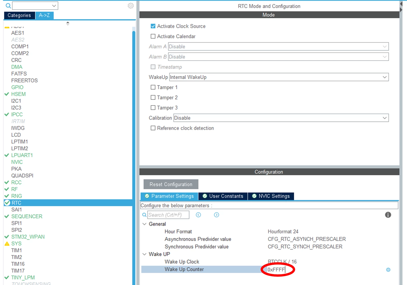

Any program that I generate using STM32CubeIDE for the STM32WB with BLE enabled hangs until I comment out the following line. What needs to change in the initialization sequence?
   * We should never end up in this case
   * However, if due to any bug in the timer server this is the case, the mistake may not impact the user.
   * We could just clean the interrupt flag and get out from this unexpected interrupt
  while(__HAL_RTC_WAKEUPTIMER_GET_FLAG(phrtc, RTC_FLAG_WUTWF) == RESET);
Best answer by Remy ISSALYS
Indeed, if the Hardware Time Server (HW_TS) is not initialized (via MX_APPE_Init()) quickly enough after the RTC initialization (via MX_RTC_Init()), the code might get stuck in an infinite loop in the HW_TS_RTC_Wakeup_Handler() function.

> Change Wake Up Counter value:
If you used CubeMX, in RTC configuration change default value by 0xFFFF:
0693W00000KaH2QQAV.pngOr in MX_RTC_Init function in main.c, change the second parameter of this function by replace 0 value:
HAL_RTCEx_SetWakeUpTimer(&hrtc, 0, RTC_WAKEUPCLOCK_RTCCLK_DIV16)
by 0xFFFF:
HAL_RTCEx_SetWakeUpTimer(&hrtc, 0xFFFF, RTC_WAKEUPCLOCK_RTCCLK_DIV16)

How will the Hardware Timer Server continue to work after I apply either of these two solutions? The first solution removes the function that enables the wake-up timer. The second one disables it.
Remy ISSALYS
February 23, 2022
Wake Up Timer is started inside Hardware Timer Server initialization see HW_TS_Init() function.
Regards

Yes @Remy ISSALYS​ , I resolved the problem using just the second part of Solution 2 above - to edit MX_RTC_Init() and disable the wakeup timer in the user code section.
 /* USER CODE BEGIN RTC_Init 2 */
 HAL_RTCEx_DeactivateWakeUpTimer(&hrtc);	// Now disable it to prevent interrupts before HW_Timerserver is ready for them.
 /* USER CODE END RTC_Init 2 */
We can close this issue.
