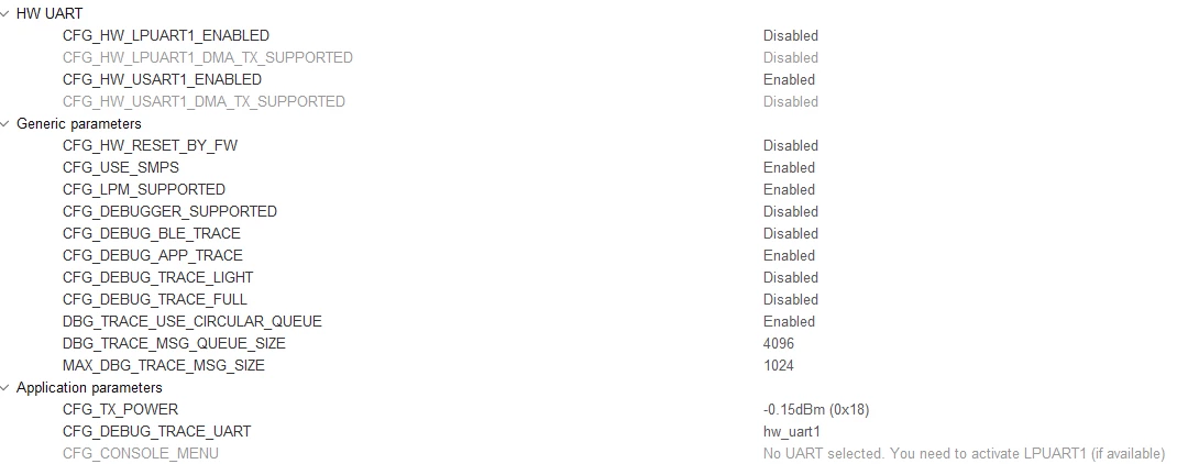

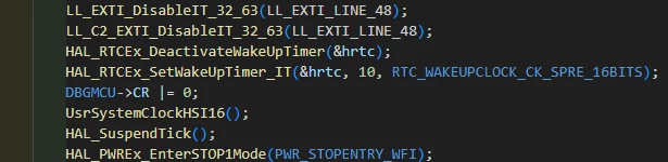

I have issues with low power in the project i am developing. As mentioned above, I want the device to always advertising and connectable. I know that the low power features of CPU1 and CPU2 operate independently, and I am trying to configure them accordingly.
For CPU2, I enable LPM Supported through CubeMX, and for CPU1, I try to configure it in the code as shown in the screenshot. I carefully follow the warnings in the Errata document while making these adjustments.
Despite performing all these steps, my custom board draws approximately 250µA, and the advertising stops, plus it does not wake up with the RTC Wakeup. I have tried many things but have not made any progress.
Note: I tried running it in STOP1 mode because I read comments suggesting that this mode operates more stably.
Looking Forward to Your Response,
