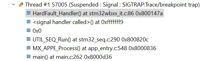

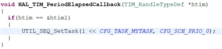

I'm using STM32WB5MMG and want to send 8-bit data through BLE every specified duration (e.g. 1s). I have tested the Bluetooth and timer interrupt separately and both works fine. However, when I tried to trigger the Bluetooth using timer interrupt as shown in the following code, both stop working.
0693W00000YAOY8QAP.pngThe error is:

You can look BLE_HeartRate example available in STM32CubeWB package which allow to send heart rate measurement to the smartphone each second through BLE using a timer (see TimerMeasurement_Id) which trig a task (see CFG_TASK_MEAS_REQ_ID) that send data each second.
