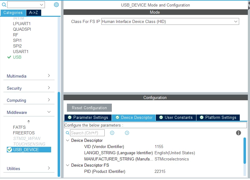

I got a NUCLEO-WB55RG board and was trying to program it as a HID device. I have configured the STM32CubeIDE and have uploaded the code to the board. Yet, when I tried connecting the User USB, it unfortunately didn't work. My computer did not recognize it as an HID device. I have switched to USB MCU on JP1.
Please help!!! Great Thanks!

First, to verify that your STM32 is OK
can you try to run this firmware example it should make your STM32 behave as a mouse
Hope that helps you solve your issue
Gyessine
Dec 16, 2025 1:19 PM UTC
Keep it powered through the st-link connector and try again. So you will have 2 cables connected. If it doesn't work, debug the code and see where it's at.
