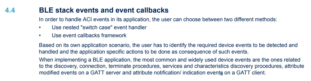

How to use STM32WB's BLE event callback framework?
I'm trying to use the STM32WB firmware event callbacks defined in ble_events.h and ble_events.c but they don't appear to be working.
According to the documentation in PM0271 revision 2 section 4.4 I should be able to use the event callbacks framework as an alternative to the switch/case event handlers.
However when I implement the event, it never gets hit (tried both with and without the __WEAK attribute):

I asked me the same question and there ist not really an satisfying answer.
The same question appears in https://github.com/STMicroelectronics/STM32CubeWB/issues/24, and now there is an Example for the Nucleo-WB55 -> BLE_Peripheral_Lite_EventCallbacks .
But in this Example the callbacks, e.g. hci_le_connection_complete_event(), are called within the Switch-Case Handler.
In PM0271 Page 38 are the event callbacks as an option the user can choose between, but that is not really the case in my understanding.
0693W00000NqXu3QAF.pngIf you want to use the callbacks, you have to use the Switch case event handler and implement the callbacks into the handler like it is done in the example:
