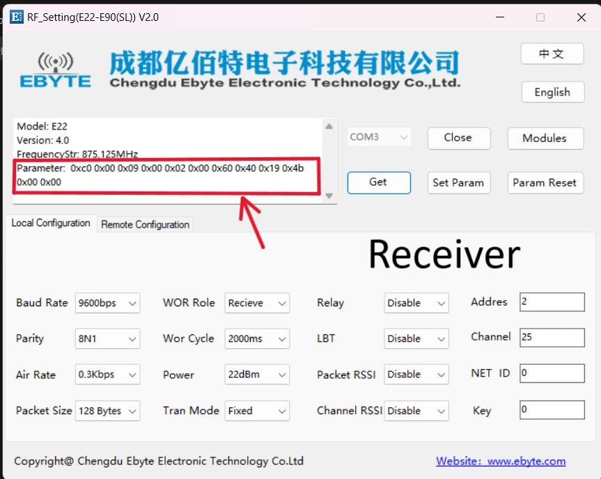

    StragerAuthor
    Dec 12, 2023 9:20 PM UTC
    I know the values of registers comes from parameters in RF Setting app for Lora. If is it true, how can I obtain, for example what is the REG1 in these parameters?
    Tesla DeLorean
    Guru
    Dec 12, 2023 10:18 PM UTC
    C0 00 09[00 - 02 00 60 40 - 19 4B 00 00]
    The 0x60 is REG0, the 0x40 is REG1
