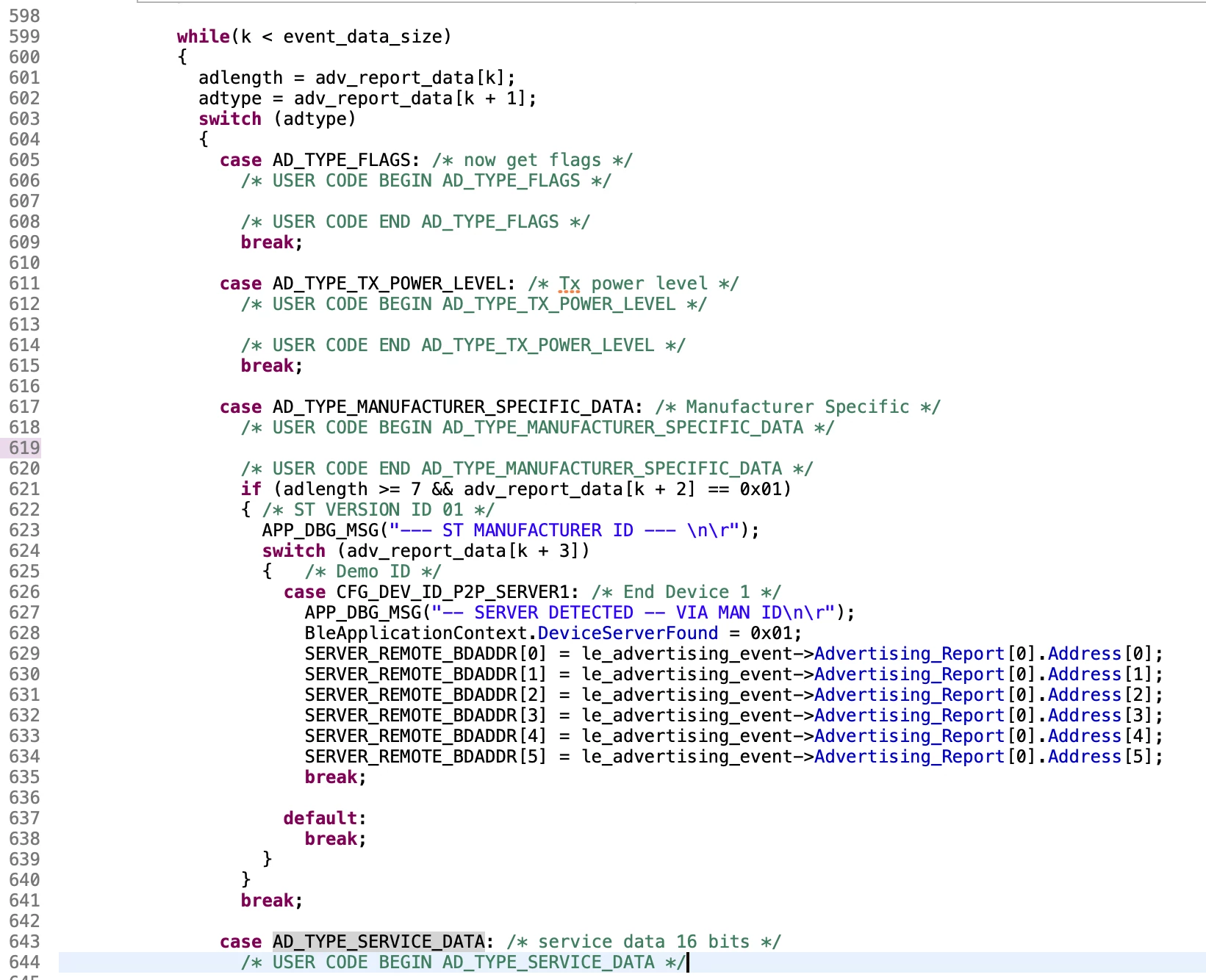

How to use an STM32 as BLE client to connect to a 3rd party BLE server?
I'm new to BLE and working on a project where I need to create a link from my STM32WB15 to a 3rd party IMU sensor. I have no access into the sensor, but I have the UUID's and advertisement data structure.
In STM32CubeProgrammer I set the parameters for the STM32 to be a client looking to link with a third party server. I believe I found the line's of code that direct me where it is pulling/finding the device UUID.
UTIL_SEQ_RegTask(1<<CFG_TASK_START_SCAN_ID, UTIL_SEQ_RFU, Scan_Request); UTIL_SEQ_RegTask(1<<CFG_TASK_CONN_DEV_1_ID, UTIL_SEQ_RFU, Connect_Request);
What I cant find is where in the files I can adjust which device it is searching for to input my sensor's UUID.
Any help would be great, thank you!
P.S. - I've been searching through header files, and other program files. I may be overlooking the exact line where I can manipulate the STM to search and connect with the IMU.

Remy ISSALYS
Mar 14, 2023 6:07 PM UTC
You can look BLE_p2pClient example available in STM32CubeWB package. This example shows how to demonstrate Point-to-Point communication using BLE component (as GATT client). In this example, the central device (BLE_p2pClient) starts scanning when pressing the User button (SW1) then when BLE_p2pServer is detected, it automatically connects to it. In the code you can look in app_ble.c file into SVCCTL_App_Notification function in the case HCI_LE_ADVERTISING_REPORT_SUBEVT_CODE, that decode the advertising report.

Remy ISSALYS
Apr 7, 2023 6:25 PM UTC
If the advertising data of your sensor contains it UUID service, you should add a case on the AD type corresponding to the UUID service and check if the UUID value matches with the UUID expected.

Remy ISSALYS
Apr 20, 2023 1:47 PM UTC
In app_ble.c file, see SVCCTL_App_Notification function:
case HCI_LE_ADVERTISING_REPORT_SUBEVT_CODE:
 uint8_t *adv_report_data;
 /* USER CODE BEGIN EVT_LE_ADVERTISING_REPORT */
 /* USER CODE END EVT_LE_ADVERTISING_REPORT */
 le_advertising_event = (hci_le_advertising_report_event_rp0 *) meta_evt->data;
 event_type = le_advertising_event->Advertising_Report[0].Event_Type;
 event_data_size = le_advertising_event->Advertising_Report[0].Length_Data;
 /* WARNING: be careful when decoding advertising report as its raw format cannot be mapped on a C structure.The data and RSSI values could not be directly decoded from the RAM using the data and RSSI field from hci_le_advertising_report_event_rp0 structure. Instead they must be read by using offsets (please refer to BLE specification). RSSI = (int8_t)*(uint8_t*) (adv_report_data + le_advertising_event->Advertising_Report[0].Length_Data);
 adv_report_data = (uint8_t*)(&le_advertising_event->Advertising_Report[0].Length_Data) + 1;
 k = 0;
 /* search AD TYPE 0x09 (Complete Local Name) */
 /* search AD Type 0x02 (16 bits UUIDS) */
 if (event_type == ADV_IND)
 /* ISOLATION OF BD ADDRESS AND LOCAL NAME */
 while(k < event_data_size)
 adlength = adv_report_data[k];
 adtype = adv_report_data[k + 1];
 switch (adtype)
 case AD_TYPE_FLAGS: /* now get flags */
 /* USER CODE BEGIN AD_TYPE_FLAGS */
 /* USER CODE END AD_TYPE_FLAGS */
 break;
 // ADD HERE THE CASE THE MANAGE AD TYPE FOR UUID
 } /* end switch adtype */
 k += adlength + 1;
 } /* end while */
 } /* end if ADV_IND */
break;
Best Regards
HGill.2
HGill.2Author
Apr 27, 2023 10:59 PM UTC
Hello Again ISSALYS and thank you for your reply!
I have been lookin at that piece of code and I was also curious on where we can find the scan report data or where in memory on the device we can find the stored data?
As for the code, our device is from "___" company. With the following UUID's and Bluetooth Address:
�?Primary Service UUID = 6d071523-e3b8-4428-b7b6-b3f59c38b7bb
�? Data Characteristic UUID = 6d071524-e3b8-4428-b7b6-b3f59c38b7bb
�? Control Characteristic UUID = 6d071525-e3b8-4428-b7b6-b3f59c38b7bb
�? BLE Address: D7:E3:4B:FD:C6:4B
_legacyfs_online_stmicro_images_0693W00000bizMiQAI.pngHow would I amend the code to work with my device as the issue I'm coming across is it appears it's currently developed specifically for an ST device? I'm trying to develop a second case statement for a "device 2" which would (ideally) connect the client Nucleo board to my Foot Tracking Sensor.
Also, in the BLE definitions file, I noticed there are different GAP appearance values, should I leave it as unknown or change it to one of the location devices? (for example: location display device).
Thank you again for your help!
