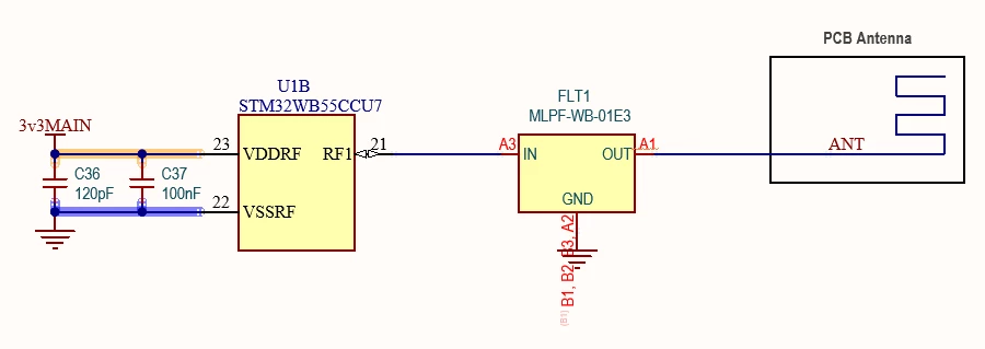

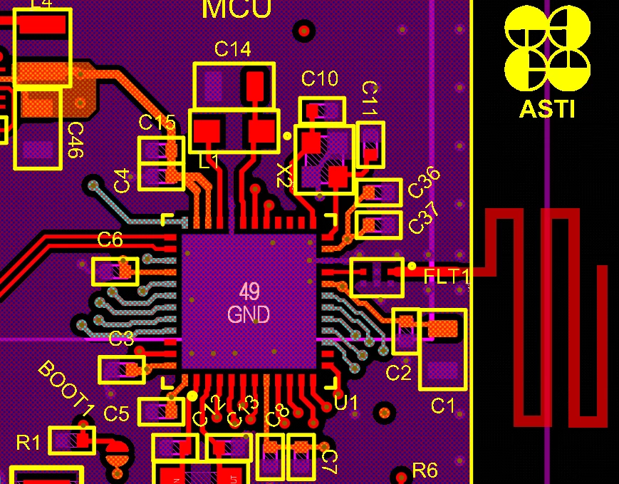

I created a custom STM32WB55 board taking hardware consideration from the RF hardware guide. Instead of a discrete matching network that was used on the Nucleo, we used IPD (integrated passive device), which was pretty much the equivalent. Based on pg.32 of AN5165. The schematic and the actual PCB design are shown below. The custom MCU of the custom board was ok, I could load firmware, debug and code just fine, but when I tried the BLE, I could not even detect the device on the BLE toolbox. I tried the Beacon sample firmware still nothing can be seen.
Can someone help me with this issue, or has somebody encountered the same problem?
I’ve exhausted the net, scouring for a possible solution, but it is hard. That is why I’m asking for somebody’s expertise regarding this.

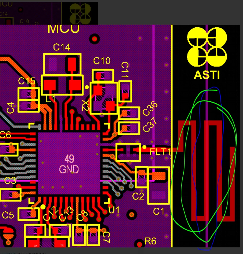

Javier1
Principal
Jan 17, 2023 8:57 AM UTC
  • Are you able to SWD debug your custom board?
  • Is your HSE XTALproviding the right freq
  • IS that a roge gnd trace going undernmeath your PCB antenna?
hit me up in https://www.linkedin.com/in/javiermuñoz/

ICMosquera
Jan 20, 2023 6:30 AM UTC
Hi @Javier Muñoz​
  1. Yes, I was able to SWD debug my board, it works like magic.
  2. HSE and LSE are perfectly working to for I was able to run RTC code snippets (RTC are clocked with LSE)
  3. That is not a GND trace, it's some silk screen at the back. The antenna trace is free of other signals even below layers.
@Remi QUINTIN​ Yep, Crystal is working fine :)
