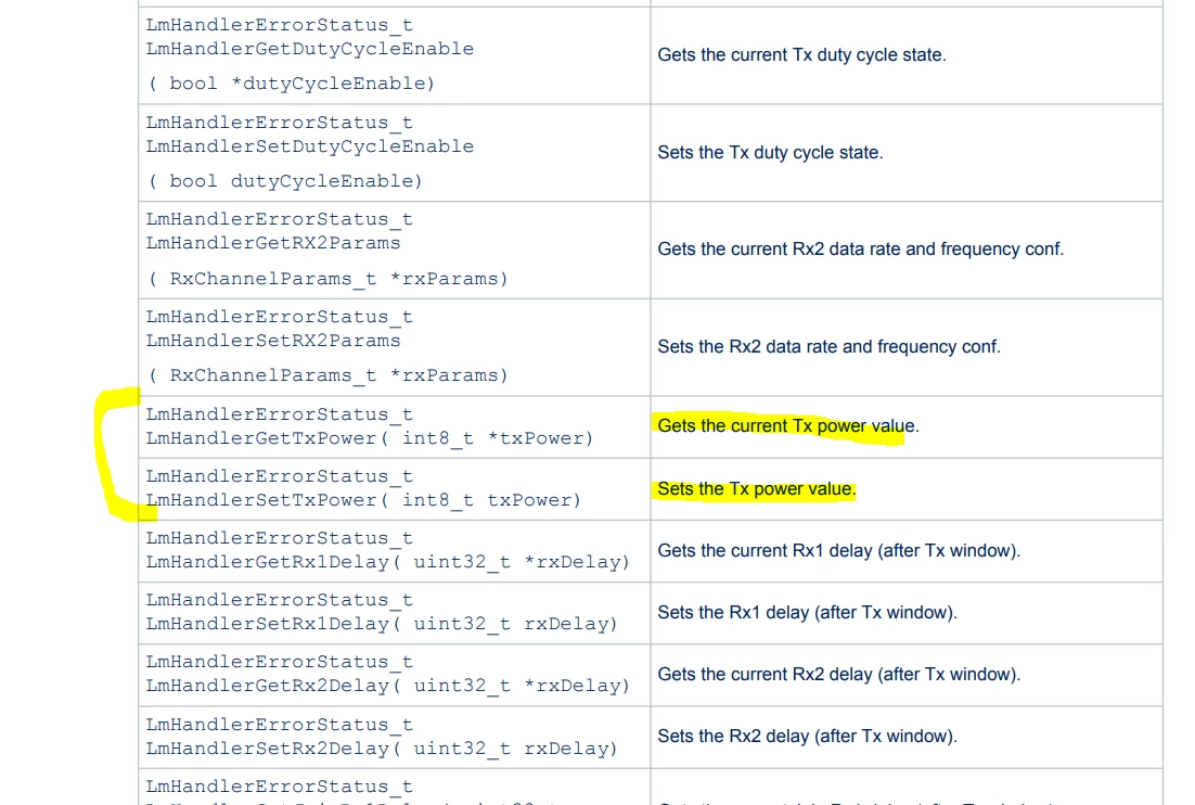

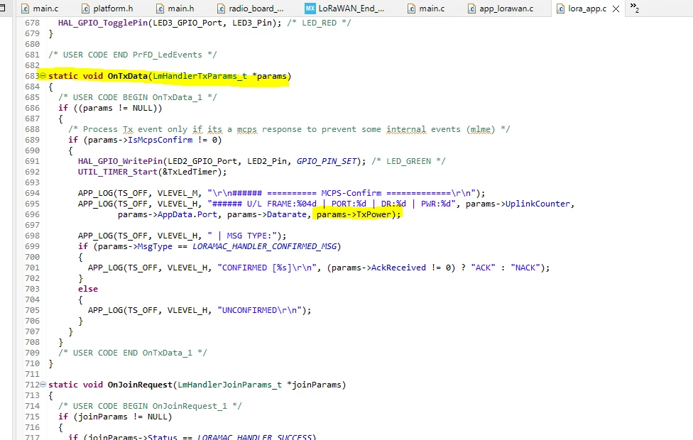

If I read TXPower using functions of LmHandler APIs, I always see 0(I think this means 0dBm output power). How to set TX power? (I've tried SetTxPower function, but I still read 0)

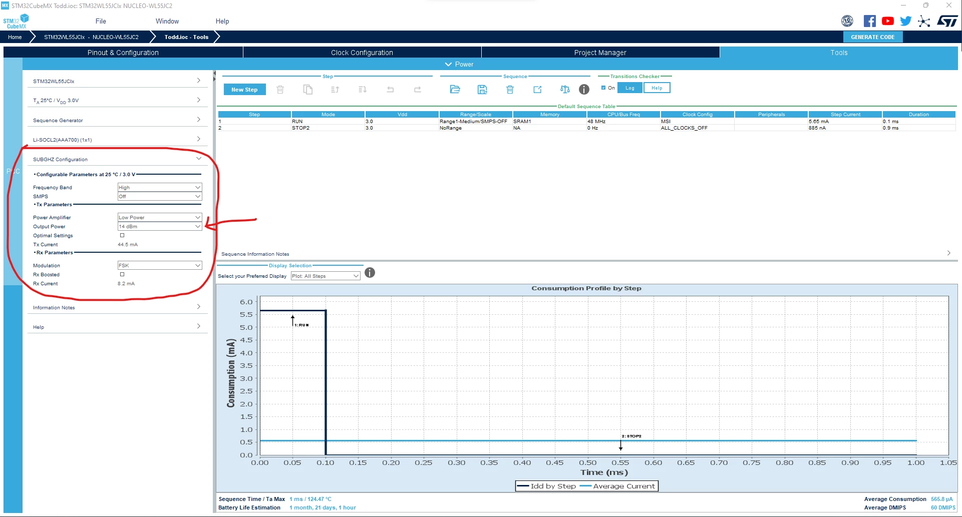

I am not sure if it meets your need, but I just saw a configuration for that in the CubeMX interface.
In the tab called "Tools", there is a left column containing "SubGhz Configuration", you can find the "Output Power" parameter there.

There're 2 options: 10dBm and 14dBm. I always see zero(0) with params->TxPower in OnTxData callback.
