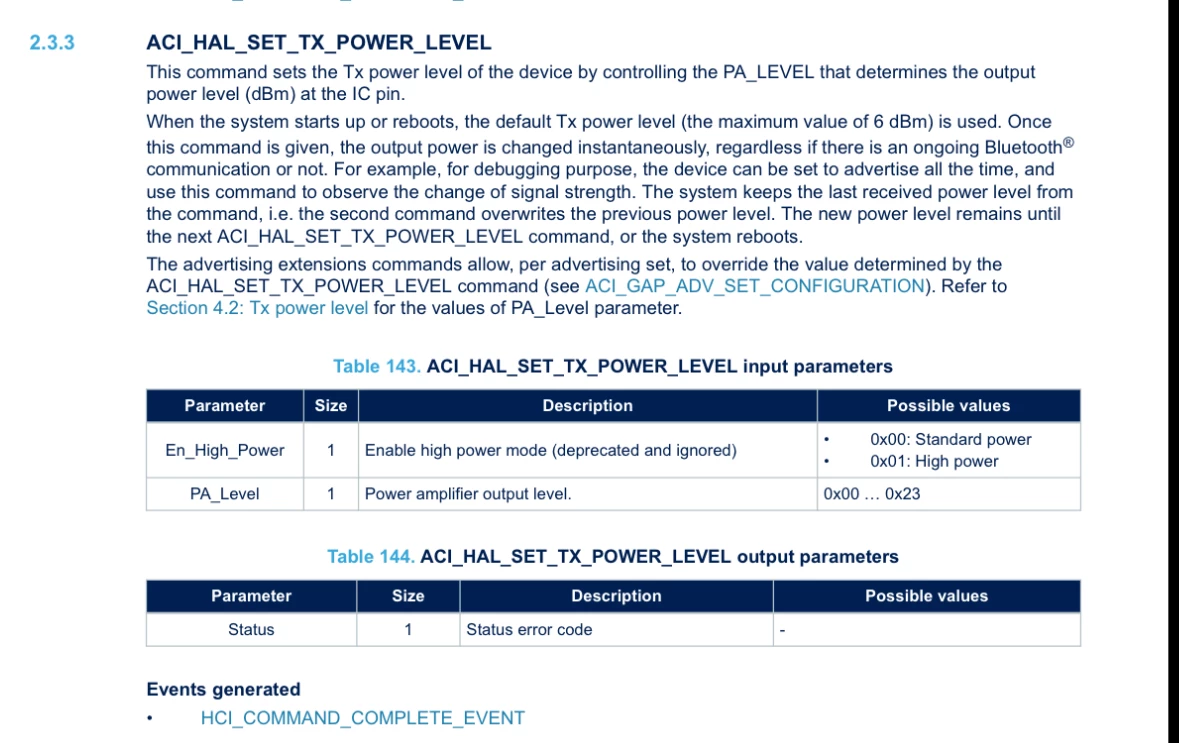

I'm investigating how to change the TX output power for hardware testing.
I was able to confirm that the power changes by writing BLE_TransparentMode to the STM32WBA25 and sending the following HCI command via UART.
0x01 0x0F 0xFC 0x02 <EnHighPower> <PowerLevel>
However, while Table 468 of AN5270 suggests that it can be set up to +6dBm, there appears to be no change in the actual output between setting it to 0dBm and setting it to +6dBm.
0x01 0x0F 0xFC 0x02 0x01 0x19
0x01 0x0F 0xFC 0x02 0x01 0x1F
Setting it to a value lower than 0dBm seems to change the output as expected.
Is it actually not possible to set it to a value higher than 0dBm?

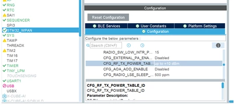

Senior
Jul 22, 2026 11:23 PM UTC
The issue was resolved by selecting "Up to +10 dBm" in the CubeMX configuration.

Jul 13, 2026 6:34 AM UTC
Thank you for the information.
I was able to confirm that the output power changes when using the ACI_HAL_SET_TX_POWER_LEVEL command.
Setting PA_Level to 0x1D returns "Unsupported," so I think this board is currently using the low power table. Is there a way to change it to the max power table?
Issamos
Jul 13, 2026 4:32 PM UTC
Hello ​@gocchan
To activate the max power table, you must toggle the En_High_Power parameter from 0 to 1 when calling the function ACI_HAL_SET_TX_POWER_LEVEL. This shifts the board's radio output from the standard low-power map to the high-power map:
Best Regards.

gocchan
gocchanAuthorBest answer
Senior
