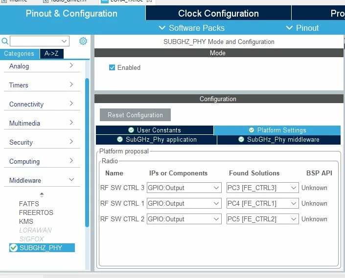

how to set RF SW CTRL pins?
Hello, How to set RF SW CTRL pins? How to make them appear in platform settings of SUBGHZ_PHY configuration?0693W00000FAJMGQA5.jpg

anyway they are controlled by BSP drivers
This is part of the drivers:
int32_t BSP_RADIO_ConfigRFSwitch(BSP_RADIO_Switch_TypeDef Config)
 switch (Config)
 case RADIO_SWITCH_OFF:
 /* Turn off switch */
 HAL_GPIO_WritePin(RF_SW_CTRL3_GPIO_PORT, RF_SW_CTRL3_PIN, GPIO_PIN_RESET);
 HAL_GPIO_WritePin(RF_SW_CTRL1_GPIO_PORT, RF_SW_CTRL1_PIN, GPIO_PIN_RESET);
 HAL_GPIO_WritePin(RF_SW_CTRL2_GPIO_PORT, RF_SW_CTRL2_PIN, GPIO_PIN_RESET);
 break;

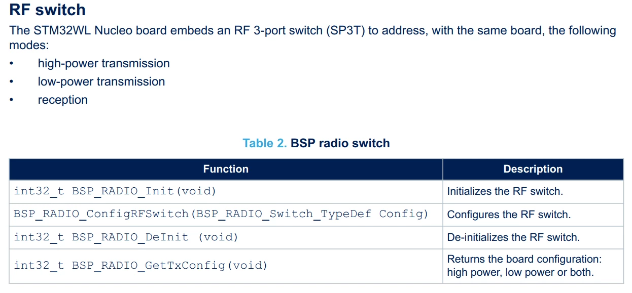

I think you should use the related API
0693W00000FAK1JQAX.pngas described on AN5406
F.
