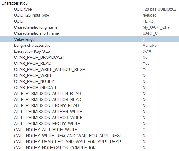

1. I made a new characteristic in CubeMX with a value length of 5 bytes and i set the length characteristic to variable because i want to send also less then 5 bytes:

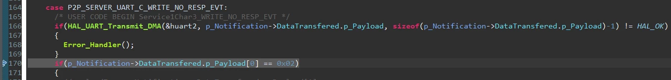

2. I started the debugger and set a brakepoint in p2p_server_app.c:
3. I checked the transmitted values in expression view:
Everything seems to be fine up to this point.
But when I try to send 3, 4 or 5 bytes, nothing happens and the program does not stop at the breakpoint. It seems that the change to 5 bytes was not reflected in CubeMX.
And when I look at the function aci_gatt_add_char() in the file p2p_server.c, I find here in the 4th argument SizeUart_C which has the value 2:
 * UART_C
 COPY_UART_C_UUID(uuid.Char_UUID_128);
 ret = aci_gatt_add_char(P2P_SERVER_Context.P2p_serverSvcHdle,
 UUID_TYPE_128,
 (Char_UUID_t *) &uuid,
 SizeUart_C,
 CHAR_PROP_READ | CHAR_PROP_WRITE_WITHOUT_RESP,
 ATTR_PERMISSION_NONE,
 GATT_NOTIFY_ATTRIBUTE_WRITE,
 0x10,
 CHAR_VALUE_LEN_VARIABLE,
 &(P2P_SERVER_Context.Uart_CCharHdle));
 Does the argument SizeUart_C define the length of the bytes? If so, then the CubeMX code generator generates an incorrect value here.

Hello @ledi001
Yes, the SizeUart_C is the Char_Value_Length. It means the Maximum length of the characteristic value. Using STM32CubeWBA V1.5.0, STM32CubeMX V6.13.0 and STM32CubeIDE V1.17.0 I've been able to create a characteristic with the size other than 2. So, it should work fine.
