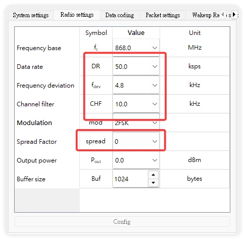

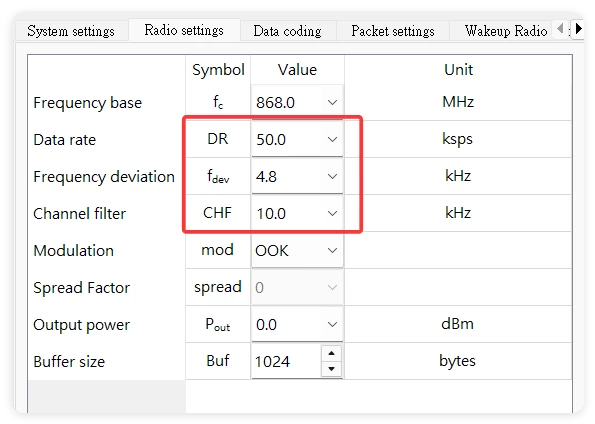

In the GUI's "Radio settings" tab we can set: fc, DR (ksps), Fdev (kHz),
CHF (channel filter bandwidth, kHz), modulation (OOK/2(G)FSK/4(G)FSK/ASK),
Spread Factor, and Pout.

1. What DR / Fdev / CHF / Spread Factor values did ST use internally to
   characterize each of the three sensitivity points above? In particular:
     - For -132 dBm @ 300 bit/s / 433 MHz / OOK: Under the test conditions of 132 dBm @ 300 bit/s 433 MHz OK, what deviation, DR, Fdev, and CHF should I use to see -132 dBm?
     - For -128 dBm @ 300 bit/s / 868 MHz / 2(G)FSK: what Fdev (modulation
       index) and CHF were used at this very low data rate?
 Is FEC enabled?

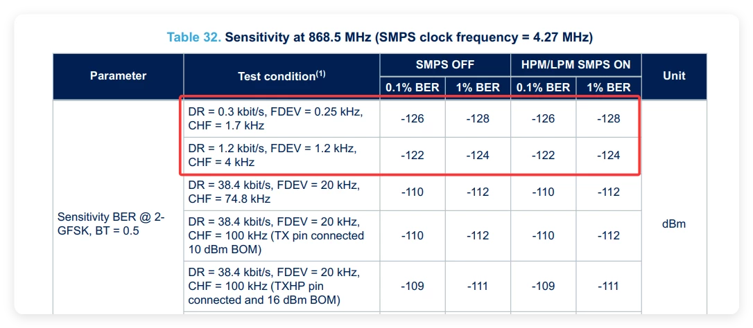

Hello WWang.15,
the configuration you are looking for are in the datasheet itself:
  • Table 30. Sensitivity at 433 MHz (SMPS clock frequency= 4 MHz)
  •  Table 32. Sensitivity at 868.5 MHz (SMPS clock frequency = 4.27 MHz)
In the paragraph “6.3.5 RF receiver” you can find the test conditions.
FEC and whitening are not enabled for these measurements.
For the OOK modulation, Fdev is not used.
BR,
Filippo

We tried using the original DK board with DR=1.2kHz and CHF=4kHz OOK modulation. We used an attenuator for attenuation, and data loss occurred at approximately -110dBm.

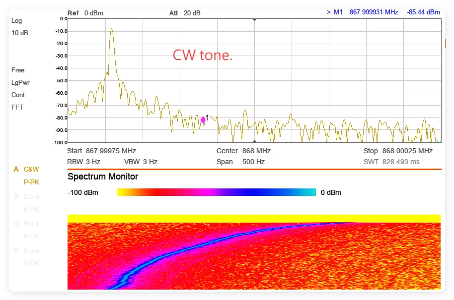

The frequency bias of this DK board are -1419Hz(DK1) and -3563Hz(DK2) using CW mode with spectrum.
When using OOK with DR=1.2kHz, is there a requirement for the center frequency bias, and if so, how many Hz should it be maintained within?

Hi WWang.15,
You got the point: when using a channel filter like 4 kHz, the offset between the nominal frequency and the actual frequency must be reduced. Otherwise, part of the signal power falls outside the channel filter bandwidth, resulting in lower sensitivity.
Considering that 1 ppm at 868 MHz means an 868 Hz offset, I suggest targeting 0.1 ppm after calibration. In this way, the channel filter is well centered on the incoming signal, and sensitivity improves.

I tried using XTAL offset on the original DK board to calibrate it to the correct frequency as much as possible. I used TX start (CW) and viewed the waveform through the spectrometer, but the thermal drift was much greater than 0.1ppm (86Hz).
Do you have any suggestions for a good calibration XTAL offsetrs method?
Also, did you use a constant temperature chamber (25 degrees Celsius) for your tests?

After calibrating the XTAL, I was able to test -131dBm using the original DK board in OOK mode.

in GFSK mode, should we control the XTAL drift to 1/3 of the FDEV right?

Hi WWang.15,
the frequency tolerance at 25°C can be compensated by the calibration.
The frequency versus temperature drift of a typical XTAL is ± 12 ppm at -30°C to +85°C (The reference temperature shall be +25°C), so the receiver bandwidth must be chosen considering the worst case: center frequency ± 12 ppm, that for 868 MHz means ± 10 kHz.
With a CHF bandwidth of 1.7 kHz or 4 kHz you need to use a TCXO with low ppm drift in temperature with respect to the receiver bandwidth, to have the signal band inside the channel filter.
Another option is to characterize the drift in temperature and use the temperature sensor of the WL3 to adjust the XTAL drift at different temperatures.
