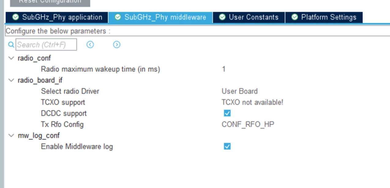

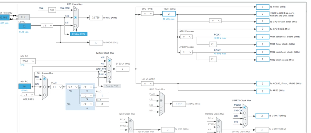

My project is SubGHZ Phy Ping Pong. In AN5568 the Rx consumption varies from 4mA to 10mA. In my project, the Rx consumption current from 8mA to 9mA. I want to reduce the Rx consumption. My configure below,
0693W00000QKYBRQA5.png0693W00000QKYBbQAP.pngPlease recommend me some solutions.
Thanks.

Louis AUDOLY
Jul 7, 2022 8:38 AM UTC
Hello @Ngô Vạn​ ,
Do you use an code you have modify and genrate from CubeMx ou you took the example in STM32Cube_FW_WL_V1.2.0 ?
First you can reduce your consumption power by disabling the LED's during an Rx and then you can check the configuration of your system.
For Rx mode, if you use a boosted LNA, LDO mode, or LoRa modulation, all these parameters will increase your consumption, so you can play with it to tune your radio to lower at the maximum it.
The matching network and the frequency have also an impact but not so important than the other parameters mentioned above. (in Tx the High Power and Low Power modes impact the consumption also)
I suggest you to refer to the SX126x datasheet on table 3-5 and 3-6 for more information on Rx and Tx mode consumption.
Regards
ngodoanvan
Jul 7, 2022 9:56 AM UTC
Thanks for your support.
I found the PWR_SMPS example code in STM32Cube_FW_WL_V1.2.0. This is my PWR_SR2 register.0693W00000QKdv5QAD.pngthe LDO is enabled. How to disable LDO?
Thanks.
