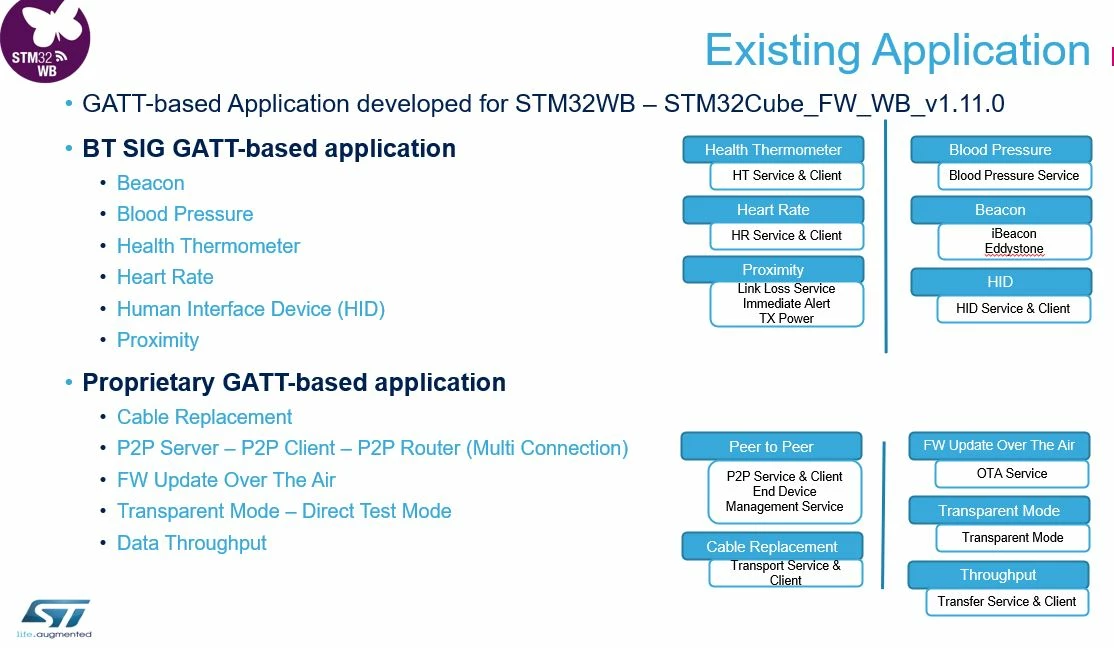

Remi QUINTIN
Sep 29, 2021 1:37 PM UTC
The attached picture details the SIG profiles supported by the WB.
