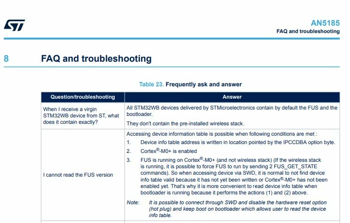

How to read fus and stack version installed in a STM32WB50
I am using an STM32WB50 and i need to find a way to discover fus and stack versions installed not using an external tool but directly by reading some register or using specific function. Is there a way to do this?
Thanks
Imen.DBest answer
Oct 7, 2021 11:31 AM UTC
Hello @MPian.1​ ,
To identify the FUS version, you need to read the shared table memory in SRAM2a. This is explained in the AN5185 in the section 1.6 Shared tables memory usage and in Section 6.1 Shared tables usage.
0693W00000FBkoiQAD.jpgHope that answers your question!

NWang.2
Apr 13, 2022 11:16 AM UTC
Hi
I have same question with my new received Nucleo-64 STM32WB55 board. I am new to the ST chipset.
I start with st web site https://www.st.com/en/evaluation-tools/p-nucleo-wb55.html and watched the first video "How to program a STM32WB55 with STM32CubeProgrammer ". The usage of STM32_Programmer_CLI.exe is shown in the video and showing erase the board first. Before I erase image on the board, I would like to know the FUS version in the board.
Below was what I did with STM32_Programmer_CLI.exe:
I set prog point to STM32_Programmer_CLI.exe first.
I have run following to try my luck:
c:\Temp>%prog% -fusopgetversion
 STM32CubeProgrammer v2.10.0
Error: Connection to target must be established before performing the fusOpgetVersion command.
By seeing the above error, I did the following:
c:\Temp>%prog% -c port=com11
Serial Port COM11 is successfully opened.
Port configuration: parity = even, baudrate = 115200, data-bit = 8,
 stop-bit = 1.0, flow-control = off
Timeout error occured while waiting for acknowledgement.
Error: Activating device: KO. Please, verify the boot mode configuration and check the serial port configuration. Reset your device then try again...
Error again.
I have images with version  STM32Cube_FW_WB_V1.13.2. I really would like to know the version on the board I received. Please recommand a tool to do the job and steps to get the job done.
Anyone can help?
Nancy
NWang.2
Apr 27, 2022 3:49 PM UTC
Issue is solved with STMCubeProgrammer tool (v2.10.0). See https://www.youtube.com/watch?v=1LvfBC_P6eg&t=314s at 3.25m.
